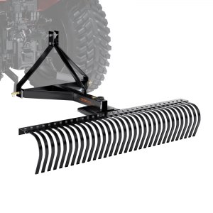

Anyone have one like this. If so, how well does it rake? Rake small stuff?
i need one that can rake small stuff. I have this one but the tines are to wide…..

I have both.
I’d say that neither one is “good” at raking. Certainly, the both are way better than not raking at all, but neither finish the job.
I use your Amazon for leaves. The bigger/thicker tines on the Vevor pull in too much sand along with the leaves (I’m in Florida). It does get more leaves but I can’t grab that pile of leaves and burn it. I use the Vevor styled rake more for driveway work, almost like a blade.

I have a similar one (Rural King brand). I wouldn't use it to rake leaves, as the Vevor pictures show - the tines are too stiff. It's great for putting the finishing touch on our gravel driveways (think kinder and gentler grader blade) and it's worked well for raking up sticks and rocks from the spoil in an area before grass is planted.

The tines on the Vevor rake are what you get on a landscape rake. The frame on the Vevor rake looks to be very thin and lightweight. I have a landscape rake that was built way better than that and managed to bend and break it to the point I had to buy heavy angle and rebuild it.
What you may need is a lawn sweeper.

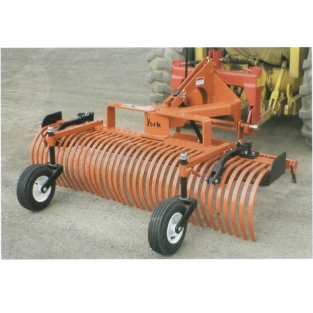

I bought a Land Pride rake, and it works very well for picking the small rocks out of the ground. Mine came with wheels, and the only thing that it doesn't have is the drop-down blade to smooth the surface as you rake the loose material. I have yet to price the parts to add it to my rake, and I did have one on my smaller CAT-0 York Modern rake. Mine is a crude 1960s model that requires extensive work to return it to usable condition.
File Picture Below.

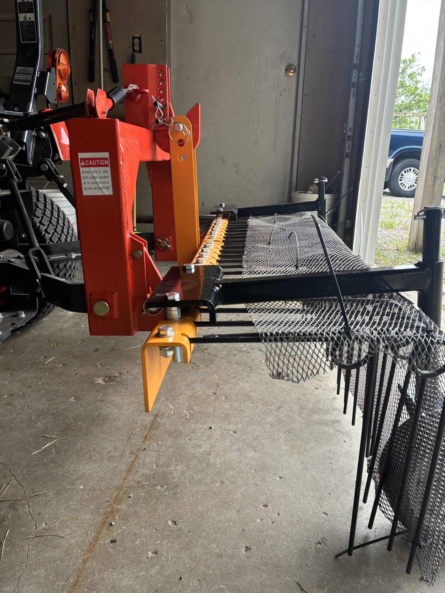

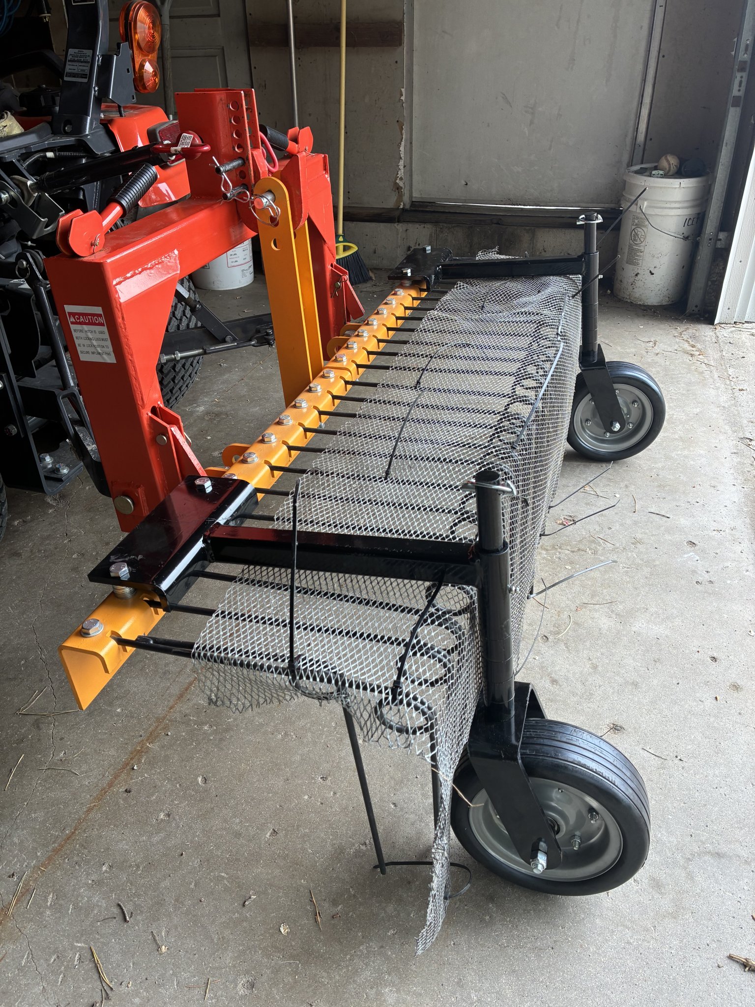

The tines are a bit wide so had this mesh laying around so put it on to check It out. Haven’t used it yet but the mesh is for collecting small stuff, like leaves and small branches. Still have some tweaking to do Before I test it out.
