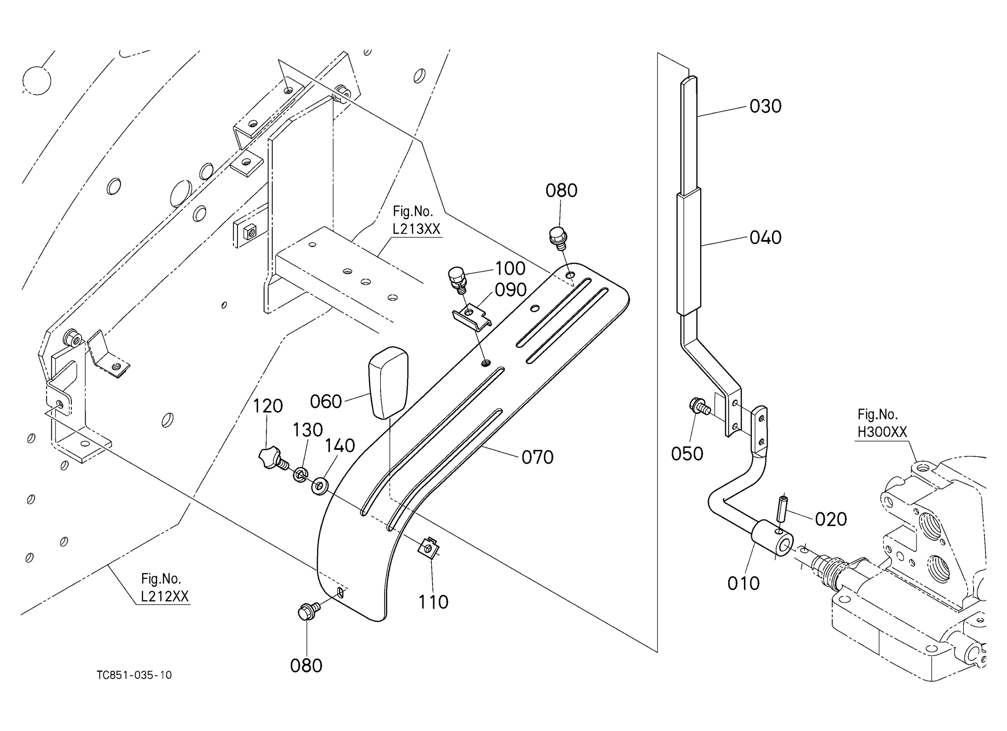

If this is the correct drawing...
maybe #020, the roll pin that connects the arm to the valve has fallen out. That would explain 'zero resistance'....

That's not the correct drawing for what I have but, it motivated me to go out and give it one more good going over and, yep, that's it! A roll pin (#15 in this drawing) fell out. Like I said, I'm not a mechanic and even knowing where it is, I tried following this drawing and it still doesn't look like it matches what I have. But, if you crawl under the tractor, contort your body just right, cross your fingers and click your heals together three times, you can see it...lol.... Now just to get the right sized pin.

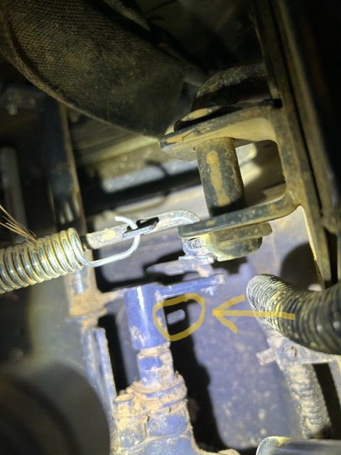

Well, after getting it parked where I could get under it and get a really good look, look what I found hiding on the back side.... 🤣😂 The spring pin has popped out just enough to be hanging on by a thread but, far enough out to not engage the shaft. Problem is that thread it's hanging by must be made of titanium. I can't get it out to save my life. Of course, it's on top of the shaft where you can barely get to it with (small) plyers or vice grips and of course, then there's no room to maneuver to push, pull or just wiggle the dang thing once you do. I'm either going to find something the same diameter and try to drive it out from the bottom (and there's no room to get a good swing with a hammer btw🙄) or just wait for the new pins to arrive and just drive it in from the bottom somehow and call it a day.
Dang, I should have just stopped, took the time to get things setup right and got a good look at the problem to begin with. But I'm old enough that everything hurts, especially when you've sent all day bouncing around on a tractor and then bend over a lot and crawl under tractors all of which tends to shorten your patience and attention span. I'm also old enough to know better than to half-arse look at a problem. 🤦‍♂️

Comgrats on finding the problem You may hsve a litte trouble getting the holes lined up. If you are installing from the bottom a drill bit or pin punch inserted from the top helps.

Could a small C clamp not press that back in?
rbargeron
Jul 6, 2015
1,170
235
western ma
A clamp might work if everything is lined up.
And when its back in, click your heels FOUR times for it to stay put. And since it worked loose once already, put a screw hose clamp around it before the heel-click thing.
