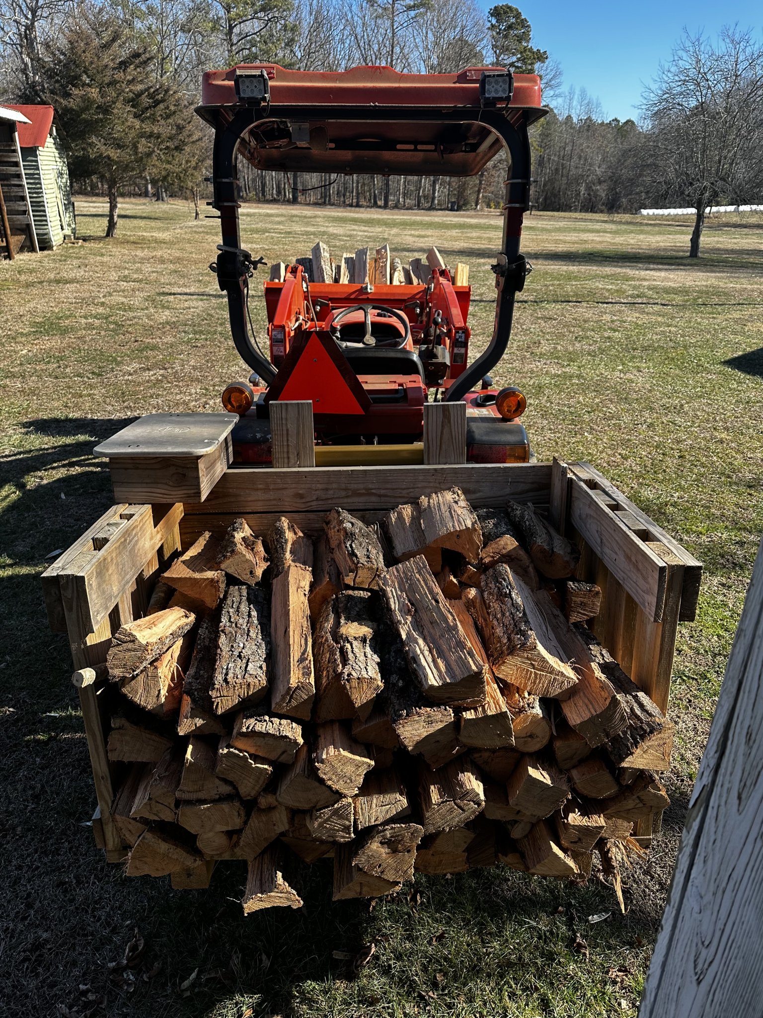

I used one of the 3-Point cary alls which are rated for 1000# and around $250. I then bolted on and made box for hauling tools and firewood on the back of mine. That said, I believe you would be good with the Titan and saving your cash.

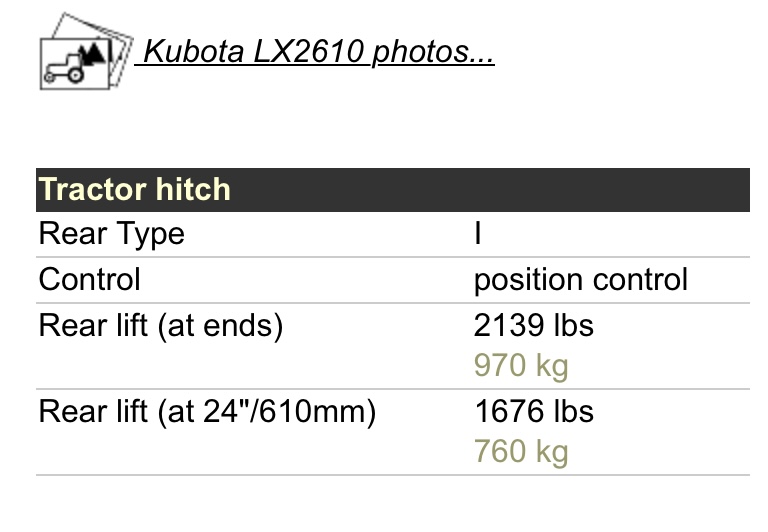

According to tractor data dot com the three point rear hitch is only capable of 2100 to 1700 pounds depending on how far back it is. I assume the front end would be pretty light unless you have something in the FEL or front weights. Do you want that much weight on your yard?
The 1500 pound implement seems sufficient since it is about all you can lift. The 2000 pound implement provides a bit more safety margin and the ability to carry heavier loads close to the pins if needed.
I would go with the 1500 version myself

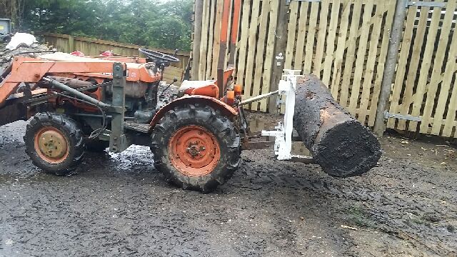

I made my own ,using 42" forklift forks. I've hauled 3000# logs with it
yes, front end was 'light' !

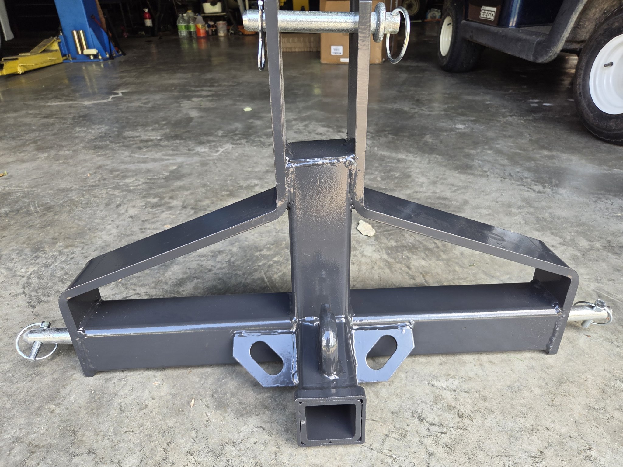

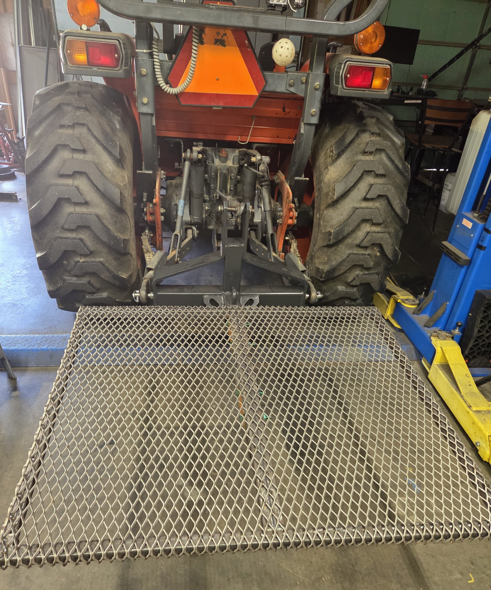

I am in the process of making a generic carry-all. I bought the 3-point adapter from Titan. If you have any cutting and welding equipment, just get the adapter and make a platform to build your box on top of. I am going to add some removable railing to mine. Removable just to keep the weight down for mounting/dismounting it.
