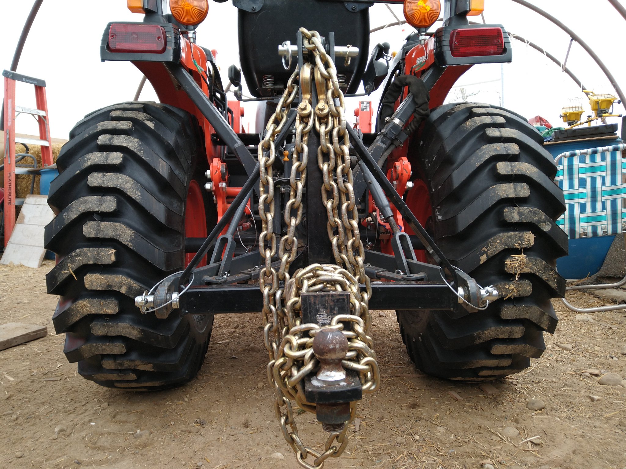

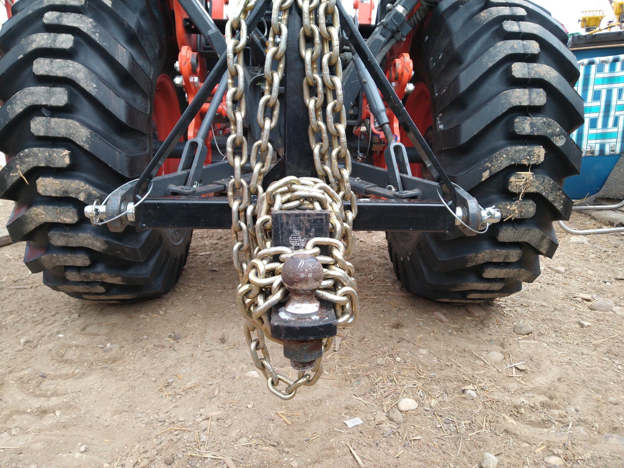

Here is what I have done with my BX. Worked well for me. It is a 3 pt 2” receiver and then one of those combo hitches with 3 sized balls and a hook on it. I put my chain around the log. Then lower the 3pt down and throw the chain over the hook. Lift it up and drag it. Not the fanciest thing, but meets my needs.

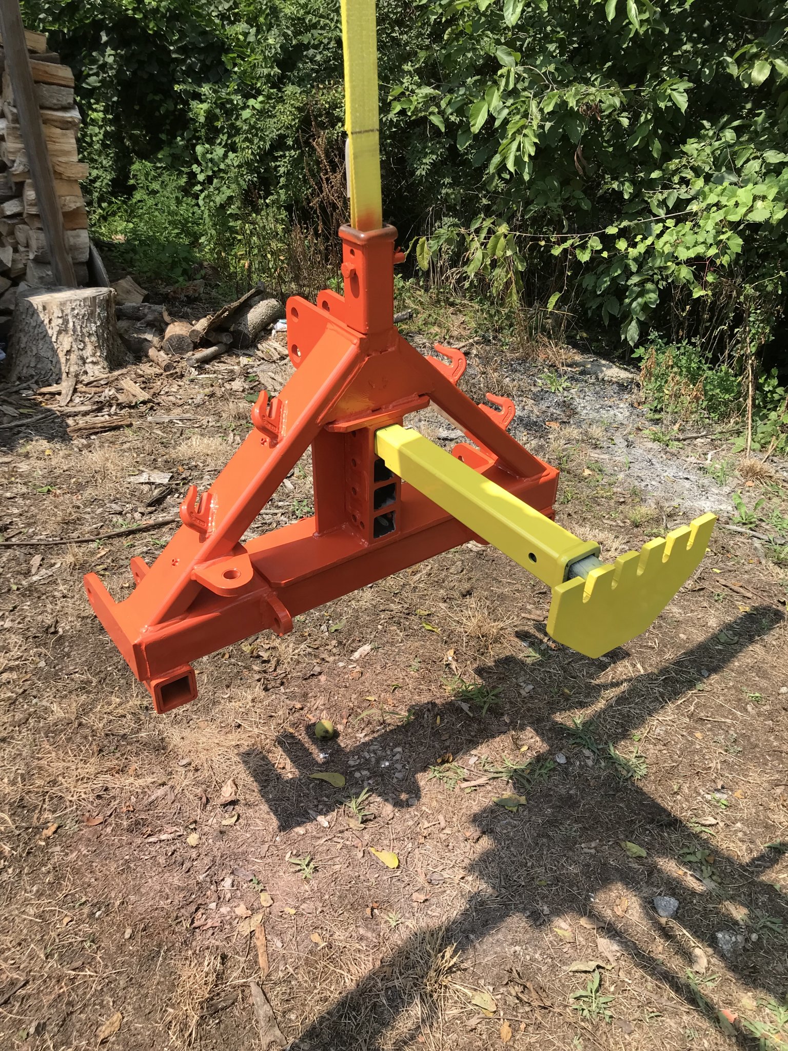

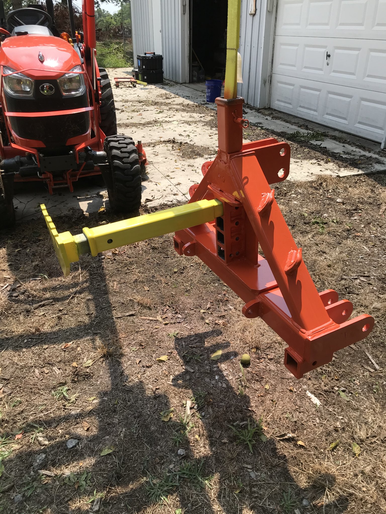

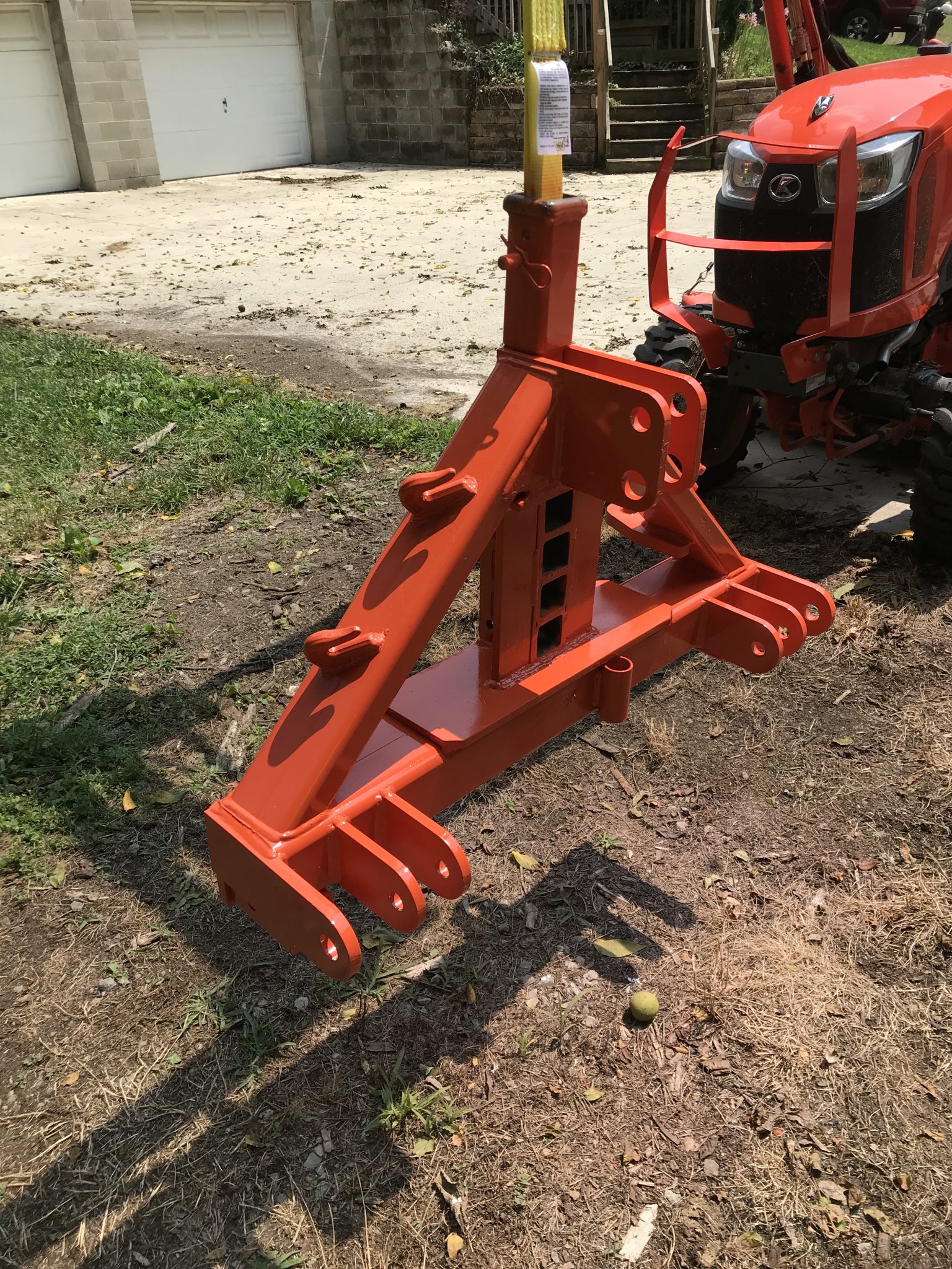

I started with the base part from a back blade and added based on my intended use from there. It’s modular so you can use as a hitch or put a wood vice in or a box or whatever will slide into a 2 inch hitch. Add some shackl bases for shackles
View attachment 66998 View attachment 66999 View attachment 67000
I really like this design. I'm curious if you would want to share the specs with me as I'm wanting to have something fabricated similar to this? I own a Kubota M62 and this looks like it would be perfect for forest work.

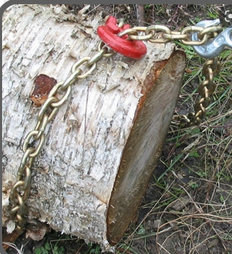

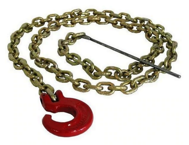

when too lazy to mount my logging winch I will use this set up very successfully (and cheap)
3pt hitch receiver
Add 2" trailer hitch
replace ball with Speeco grab hook
Use a logging choker around log (or whatever) and drop chain quickly on any link on the grab hook, lift and go.

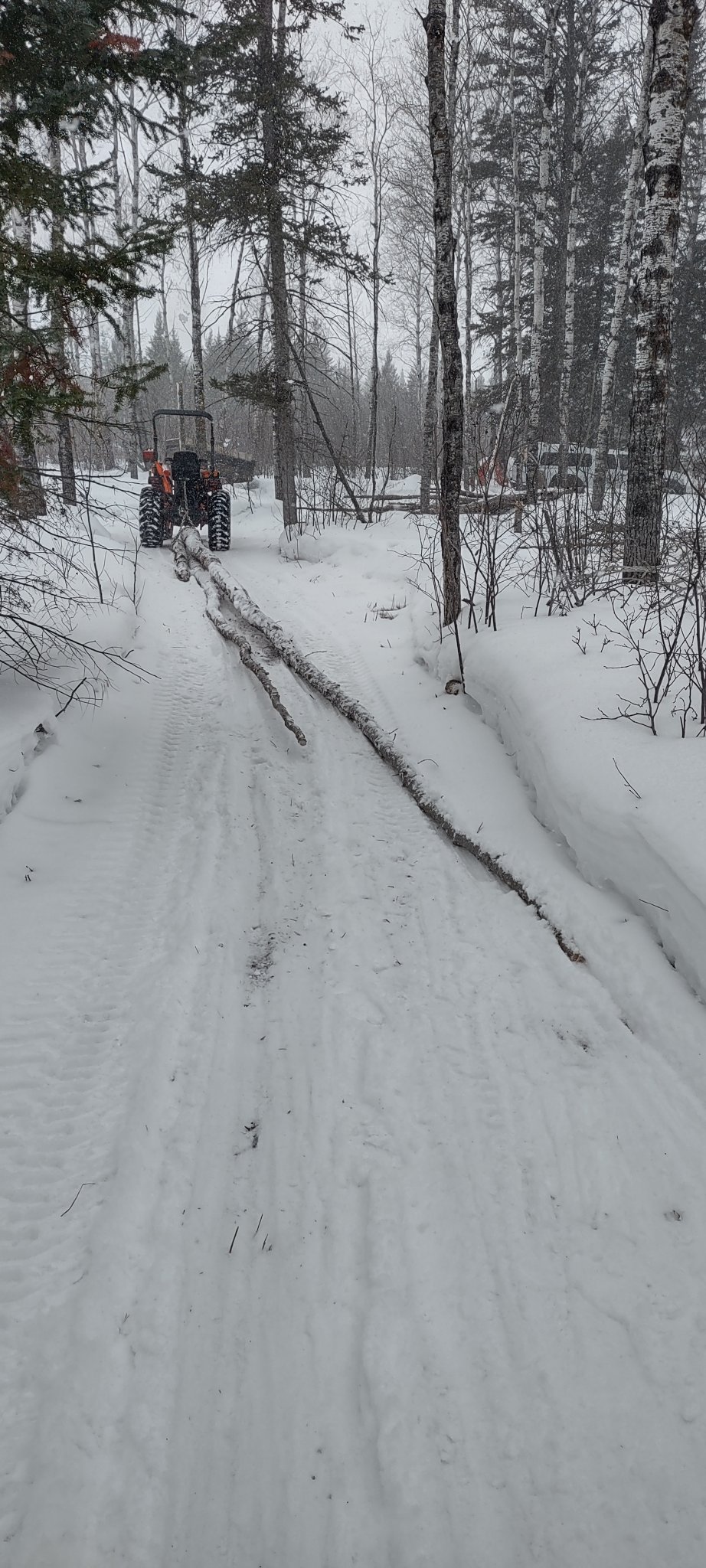

Using my Maxxhaul 50039 3-point hitch receiver for logging. That photo shows a 3/8" class 70 chain, but I've since re[placed it with a 1/4" class 70 with a slip hook at one end for log choker work. WAY lighter chain and easier to handle, and the choker hook binds log bundles for dragging them like a dream.
The Maxxhaul prob won't fit the quick hitch 3-point system, though. IMG_20210203_153858868.jpg IMG_20210203_153851335.jpg IMG_20210203_153716395.jpg IMG_20220308_140818429_HDR.jpg
