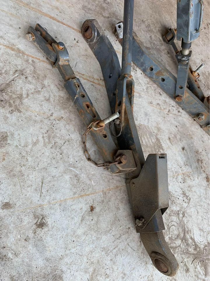

found this one for sale locally, anyone know what the lever at the end of the lift arm is for ?
Those are "telescoping arms". You release the lever and the ends slide out 3 or 4 inches to make it easier to pin the attachment without getting the holes exactly lined up when backing up to the attachment. There's a slot you lift the extension out of - once you have the pins in place, just back up a few inches and it clicks back into place. Probably from a later model L series and unless your rear tires are not the same size as newer L's, I would guess it likely fits your L3650 also.
Thanks very much , I ended up purchasing it .
