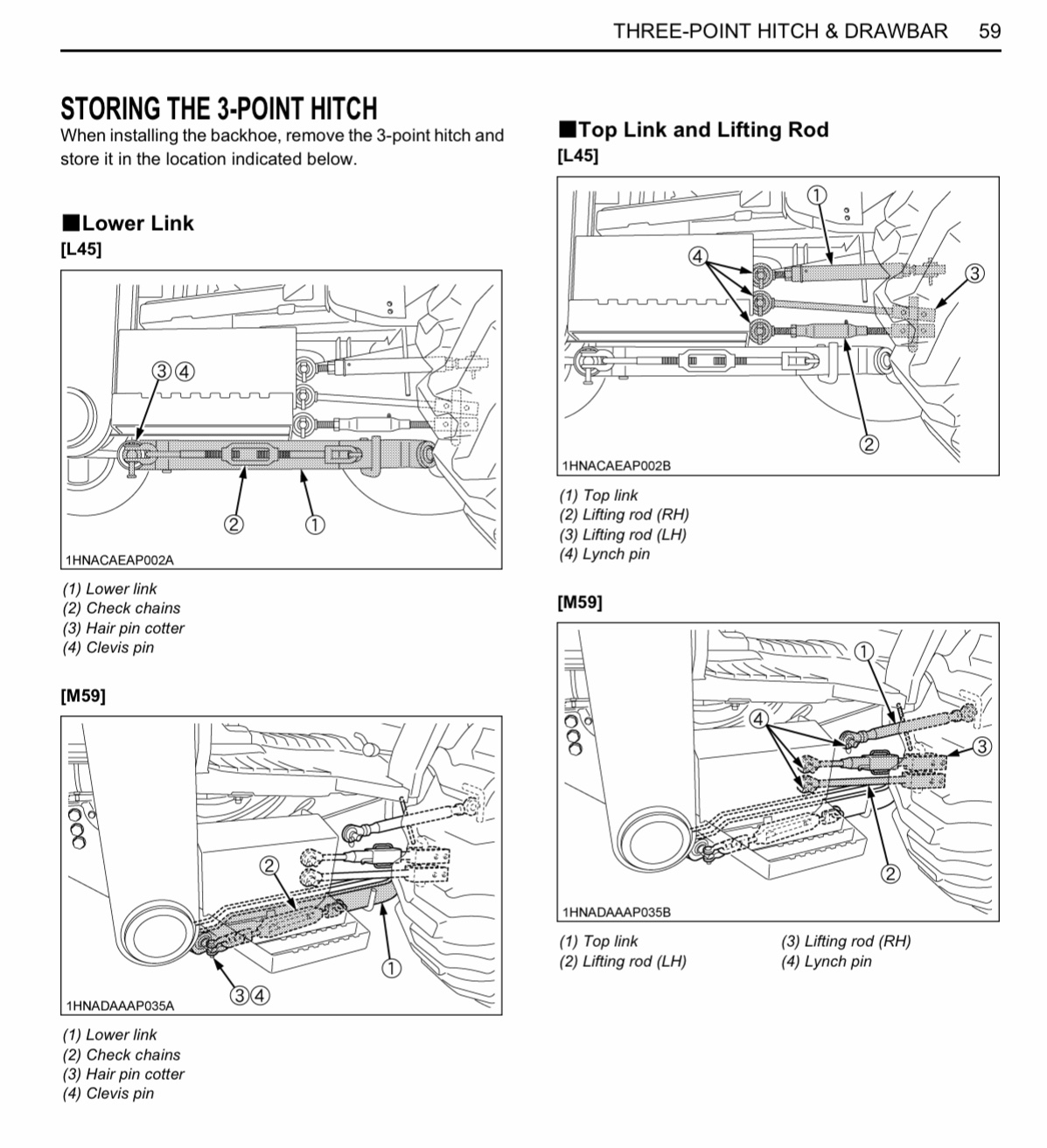

Any one have a pic of how the three point hitch pieces are stored on left underside of m62 on optional bracket?

Dealer is who talked me in to the optional 500 buck storage so not so quick to follow a dealers advice , but I do appreciate your reply , what I am looking for is a schematic or photo of the pieces and how they are arranged on the bracket attachment if someone has it

You’re the man!! Thanks- don’t know where you found schematic but that’s exactly what I needed -
I found the schematic in the owners manual.
Here's the pic I was promissing - if I were going to use onboard storage I'd very generously coat all the parts in fluid film.
