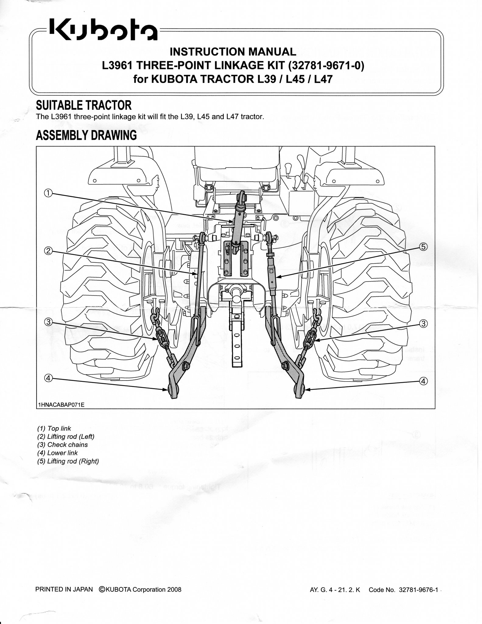

You can buy an L3961 kit. I bought one from my dealer for just over $500. I haven't had it on yet, but it should fit. It's listed for L39, 45, and 47, not the L35 since our L35's came with it and it was optional on the later models.
I've been meaning to post pictures and dimensions, but haven't got a round tuit. Here's a few pictures. You get everything in the diagram, including the top link, bolts, etc. 20210307_152817.jpg L3961 IM001.jpg You get a few parts you won't need on an L35, since they're already installed.

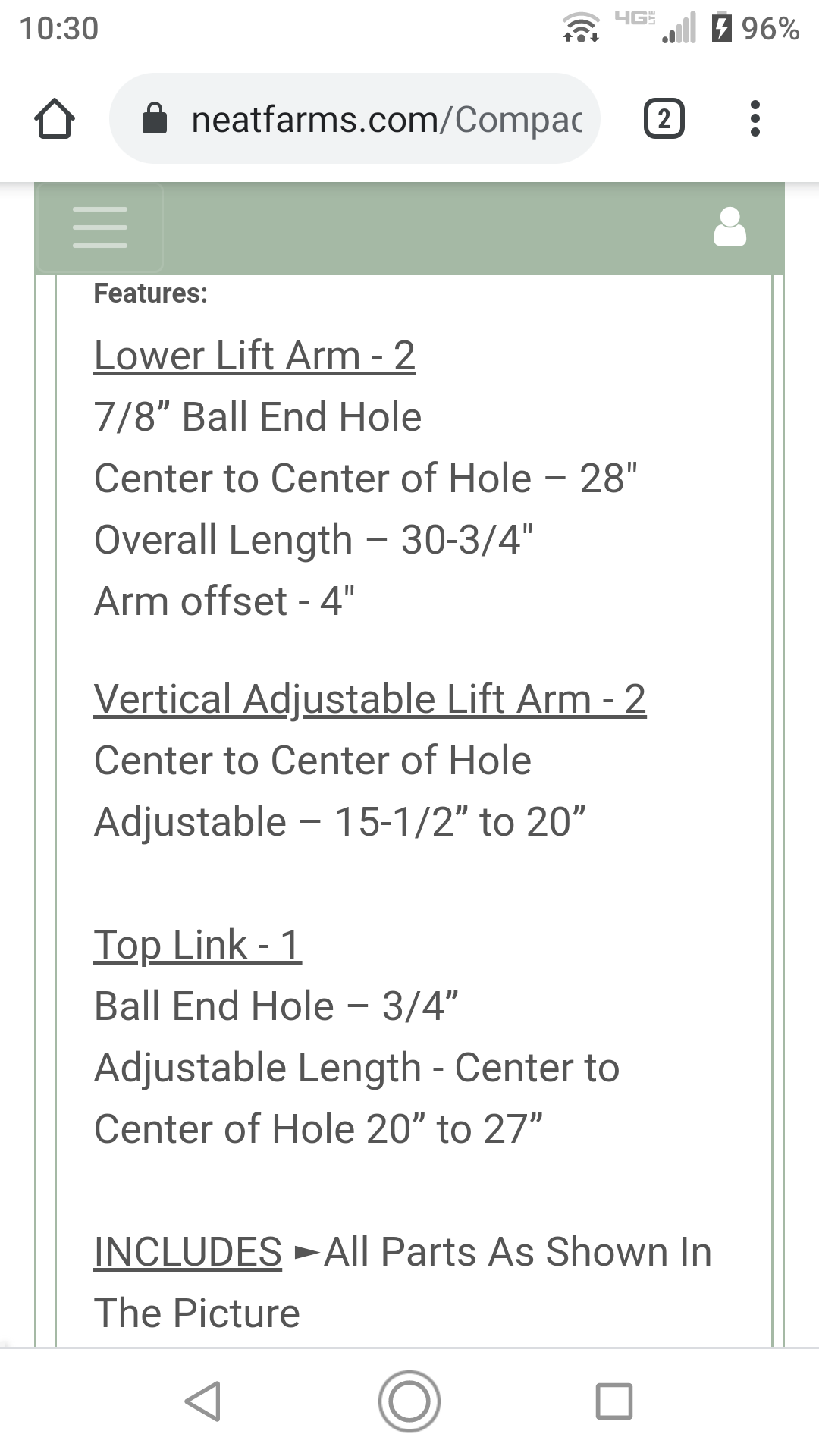

I'll look into that. My local kubota just told me it was $1950 if I bought it piece by piece. I've attached a picture of a set I found that's $300. There are 2 individuals who said the $300 kit fits their L35.

It is likely that the compact tractor kit will connect to the tractor but also likely that the arms are to short to be optimal

I'd be leery of the aftermarket ones. There have been reports on this forum of people bending the lower arms on the ones they bought on Amazon (but I don't recall if they had L models). If I recall correctly, the lower arms on the L3961 kit are 3" x 3/4" thick - they're serious stuff.
I've been meaning to post pictures and dimensions, but haven't got a round tuit. Here's a few pictures. You get everything in the diagram, including the top link, bolts, etc. View attachment 63350 View attachment 63351 You get a few parts you won't need on an L35, since they're already installed.
View attachment 63350 View attachment 63351 View attachment 63350 View attachment 63351

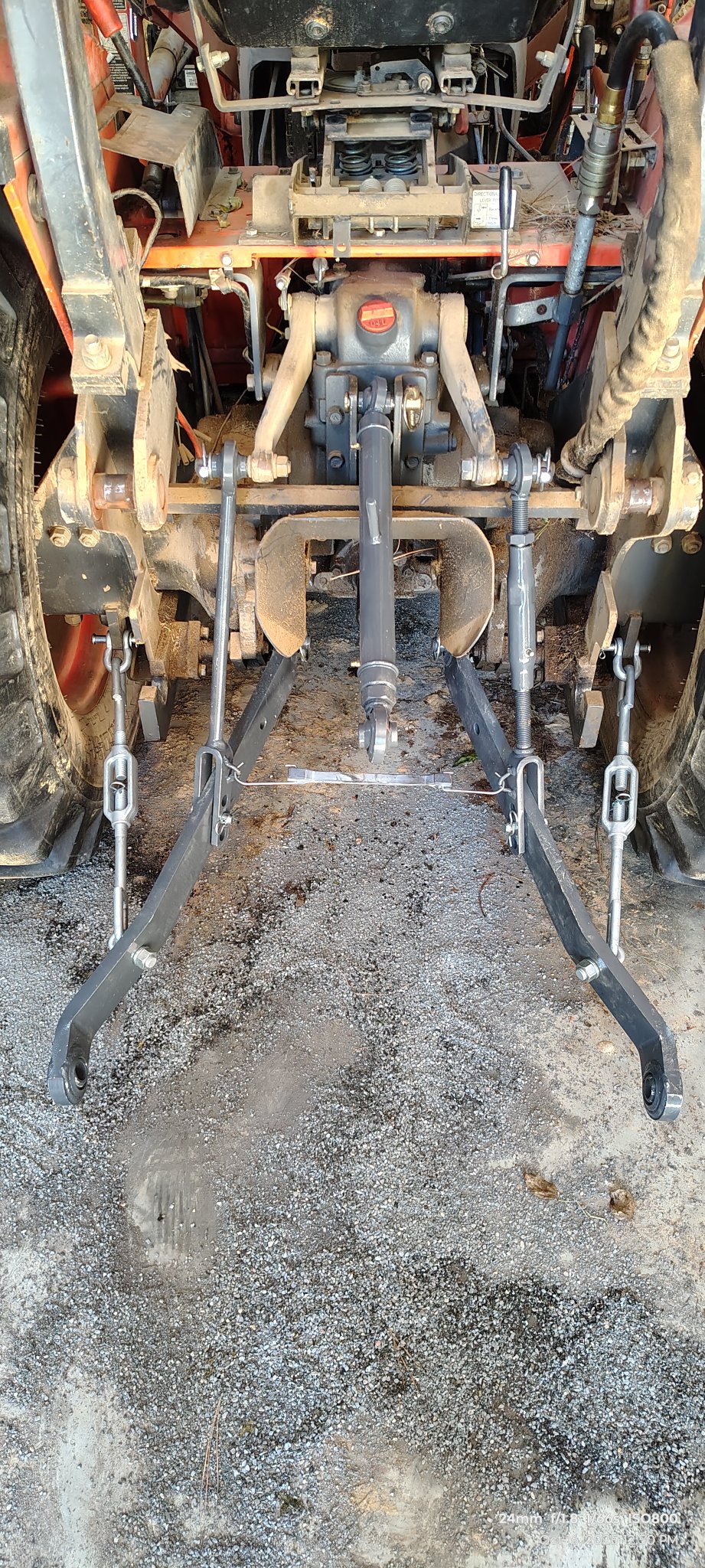

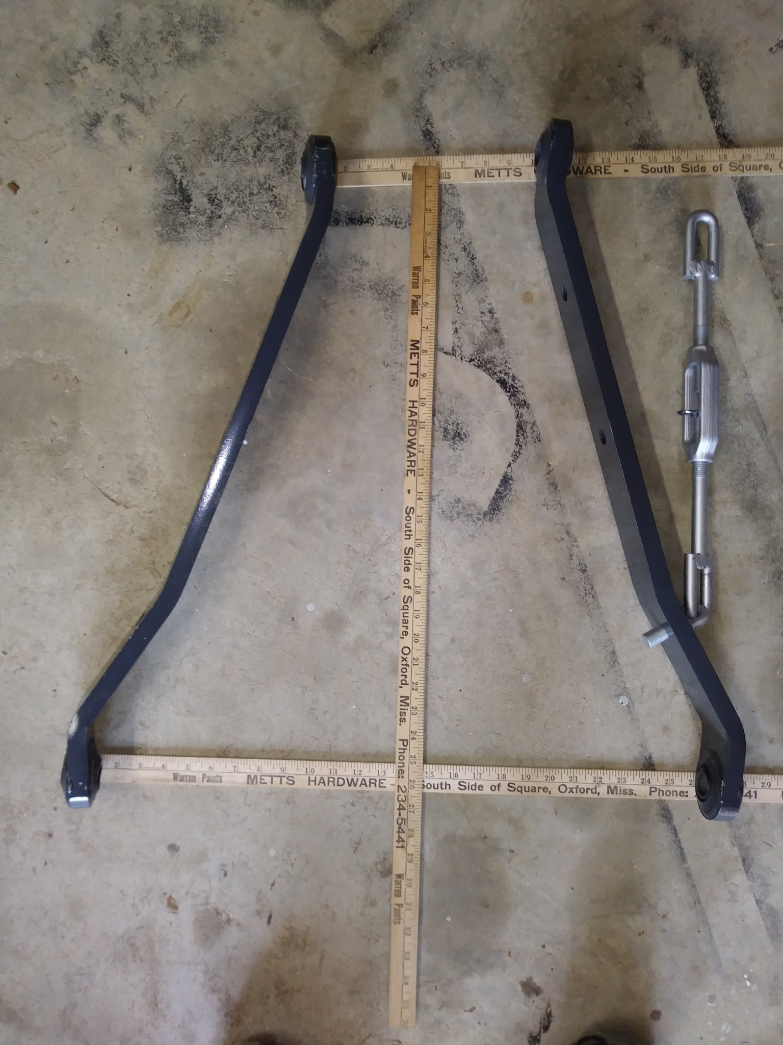

I've finally removed the backhoe and installed the L3961 kit. Here are some dimensions.
The front and rear holes in the lower arms are 7/8", same as cat 1
The front of the lower arms is 10" apart on the L35
With the arms 27" apart, as per cat 1, the front and rear holes in the lower arms are 24" c-c, front to back
The lift rods are 20" long, c-c
The lift rod ends are 3/4", top and bottom
The stabilizer attachment to the tractor is 1/2" diam.
The top link has 3/4" connections front and back. The top link is appropriately 18" long at its shortest
