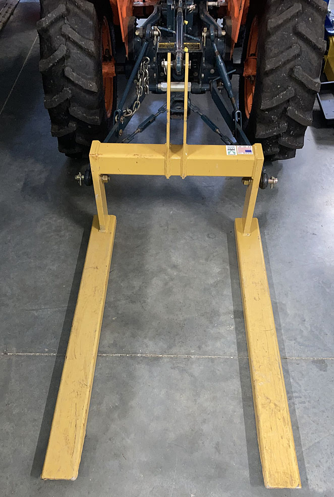

I have a set for my small machine and really like them. You might have to add front weight like I do, or you'll be steering with you rear tires, which is always fun.

Here is a better pic. It's a Northstar 1200 model. 1200LB (544KG) weight rating mounted to my 19hp machine.

Hi, that looks quite comfortable on that little tractor, I'll probable go ahead and order some at some point. Thanks.
