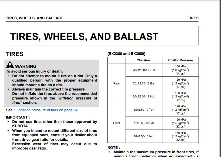

One last bit of information. Changing tire size changes the front to rear "ground covering ratio". This is why it is strongly recommended that you stick to tire size(s) that that are factory specified. A tire size change could reverse the front to back ground covering ratio, and make steering a real problem. Buy any brand you want to buy (or is available) , but be careful if you change size. Oddly enough, Kubota refer to the front to back rotation ratio as the "gear ration". Doesn't seem to be the best choice of words to use BUT Kubota does what Kubota does.
