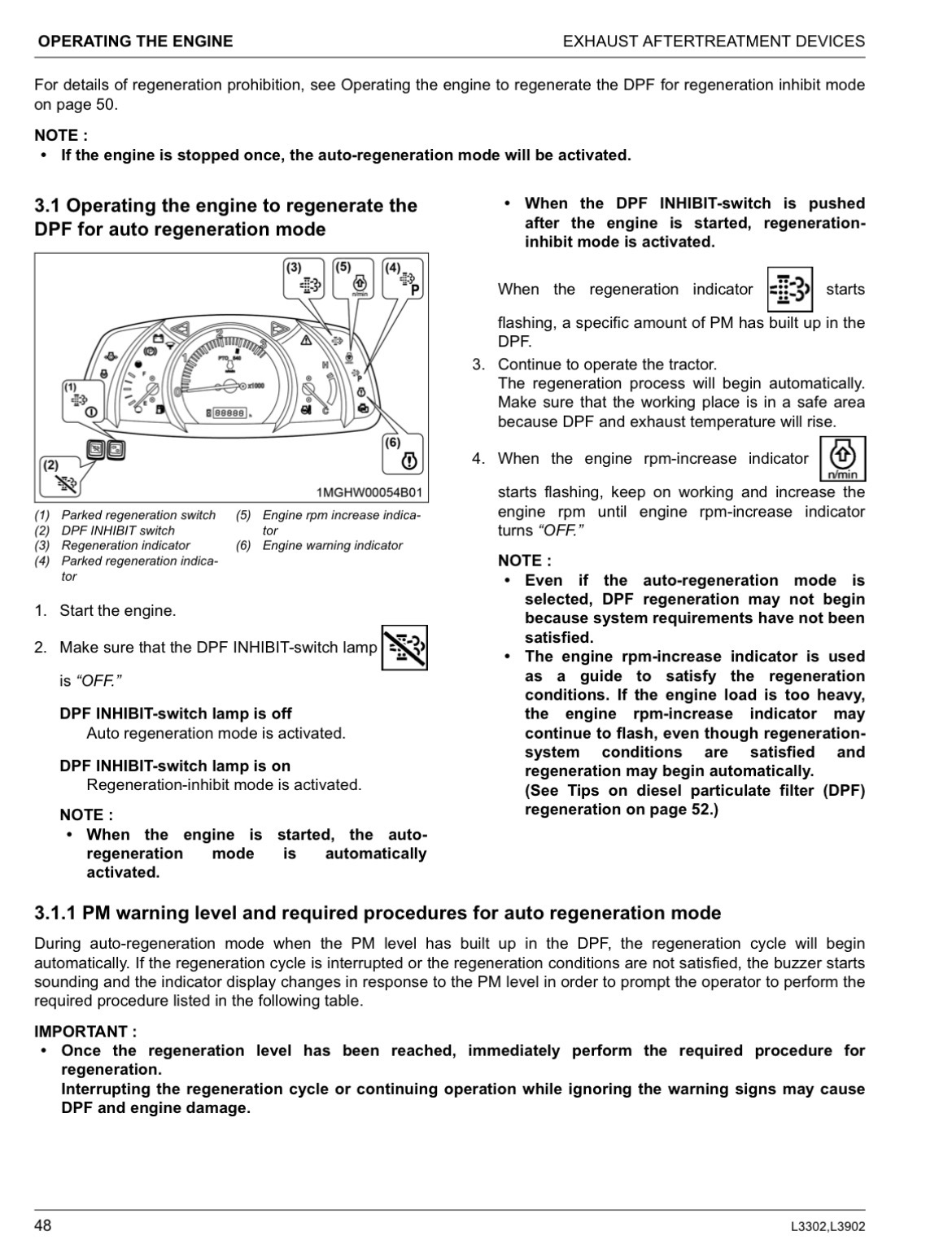

I have the exact same tractor and never have I been able to do the auto regen.
I have had what you had happen all three lights were flashing, the manual states that
you will get the regen light and the rpm light flashing where your need to raise the RPM until the rpm
light stops flashing.
My tractor has like 121 hours on it and i believe it needed a regen twice, first around 40 hours and
then at 120 hours. Guess I have to read the manual to the tractor so that it follows the book.
From the manual so yea.
NOTE :
• Even if the auto-regeneration mode is
selected, DPF regeneration may not begin
because system requirements have not been
satisfied.
• The engine rpm-increase indicator is used
as a guide to satisfy the regeneration
conditions. If the engine load is too heavy,
the engine rpm-increase indicator may
continue to flash, even though regeneration-
system conditions are satisfied and
regeneration may begin automatically.
(See Tips on diesel particulate filter (DPF)
regeneration on page 52.)

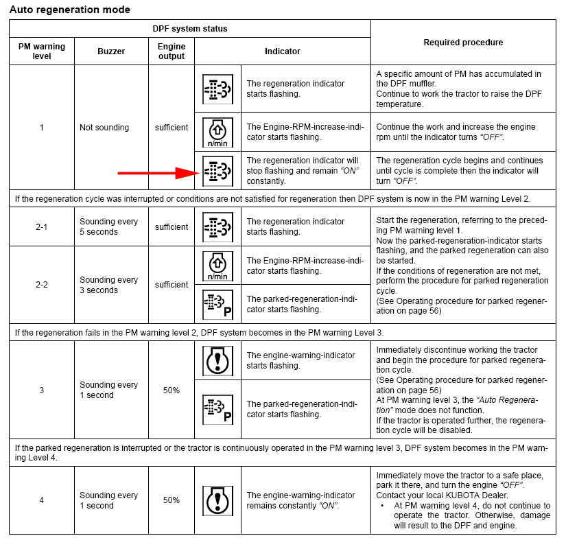

I don’t have a L3302. Looked at the instructions in the OM to confirm it works same as my L4701. Per the L3302 OM, they work the same. A bit over 600 hours, I’ve never done anything other than auto regens. I have never touched the DPF Inhibit switch.
Unless the DPF Inhibit switch is lit, which it should be if and only if you pressed it, when the tractor calls for a regen, you should see the yellow smoke puff looking light in the upper right corner of the dash.
If RPM needs to be increased, the n/min light with the thing that looks like a M67 hand grenade with an arrow pointing up will be flashing. Increase RPM until it stops flashing. You can stop or keep working, but you must maintain that RPM until the puff of smoke light goes out.
You may have noticed, at no point in that process are any buttons pushed. I have the same two DPF buttons on mine that are shown in the page out of the L3302 OM above. I’ve never touched either of them.
I have had a couple times when I was concentrating so much on what I was doing I didn’t notice the lights on the dash, but did notice a slight change in engine exhaust tone, which caused me to look at the dash and then see the light. But if you’re seeing the three lights, don’t know why you’d miss two lights.
To directly answer your question about auto regen occurring without you knowing about it in some circumstances, I have had that happen when running my chipper at 540 PTO RPM. Went to shut it down to take a break and noticed the puff of smoke light on, but the M67 grenade light wasn’t. It finished the regen by itself about 2 minutes later, so it had been running regen for probably at least 10 minutes.
If it doesn’t work as described in the OM, I’d say there’s an issue. I don’t have a L3302 and I’m not a tech, so take that for what it’s worth.
What you describe is exactly how I used to deal with regens in the MX and M. If your rpm is sufficient, the only indication that a regen is occurring is the indicator (shown with an arrow below) staying on, but not flashing, until the regen is complete.
