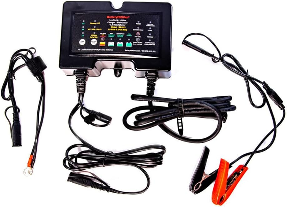

i've found if a battery is failing from a dendrite short (crystalline growth) it can draw a large amount of current and not remain charged due to the leakage. A "less expensive" maintainer that doesn't limit current output will "giver 'er all she's got, Capin'" and likely melt down due to excessive current delivery.
I go to the local industrial battery store and get higher quality batteries, which have treated me quite well over the years. I also use a temperature compensating maintainer (NOCO quietly removed the circuitry to do temperature compensation so I use a BatteryMINDer which has paid for itself a few times now).

Thank You. I will look into the battery minder. I have never heard of the temperature compensating maintainer.

A note on that: NOCO uses 19V pulses (last I checked) to break up sulfates, though I personally would disconnect the battery from anything with an ECU because in my experience anything over 14.8V could cause damage depending on what its applied to (though it's generally not an issue until over 15.2V).
The unit I suggested uses a harmonic frequency of sulfate that causes it to break up...if I remember correctly.* What I have seen it do is rescue batteries that got drained to 3 to 5 volts from months of sitting with a parasitic drain, both car and motorcycle, quickly, when several other chargers could not bring those batteries back. I did have a motorcycle battery the previous owner flattened over years of abuse that it could not bring back, so don't expect miracles, but that unit does work exceptionally well in my opinion.**
I also buy the biggest battery that fits because they aren't worked as hard (so likely last longer) and have more on tap in cold weather, though I live in a climate that's cold 1/4 of the year.
*Which upon looking it up, apparently I do remember correctly: "...pulses are set to resonate the sulfate crystals allowing them to breakup at the molecular level thus un-bonding the components of the crystals made up primarily of sulfuric acid and lead chemically described as pbSO4. ...." -FAQ
**I can't speak to how other units work because I use that model with a breakout box (they make cords for that but I fused everything...not saying the investment was worth it) in several locations. I did have one display go out after around a year of use and they replaced it promptly under warranty, and that to date is the only problem I've had.
