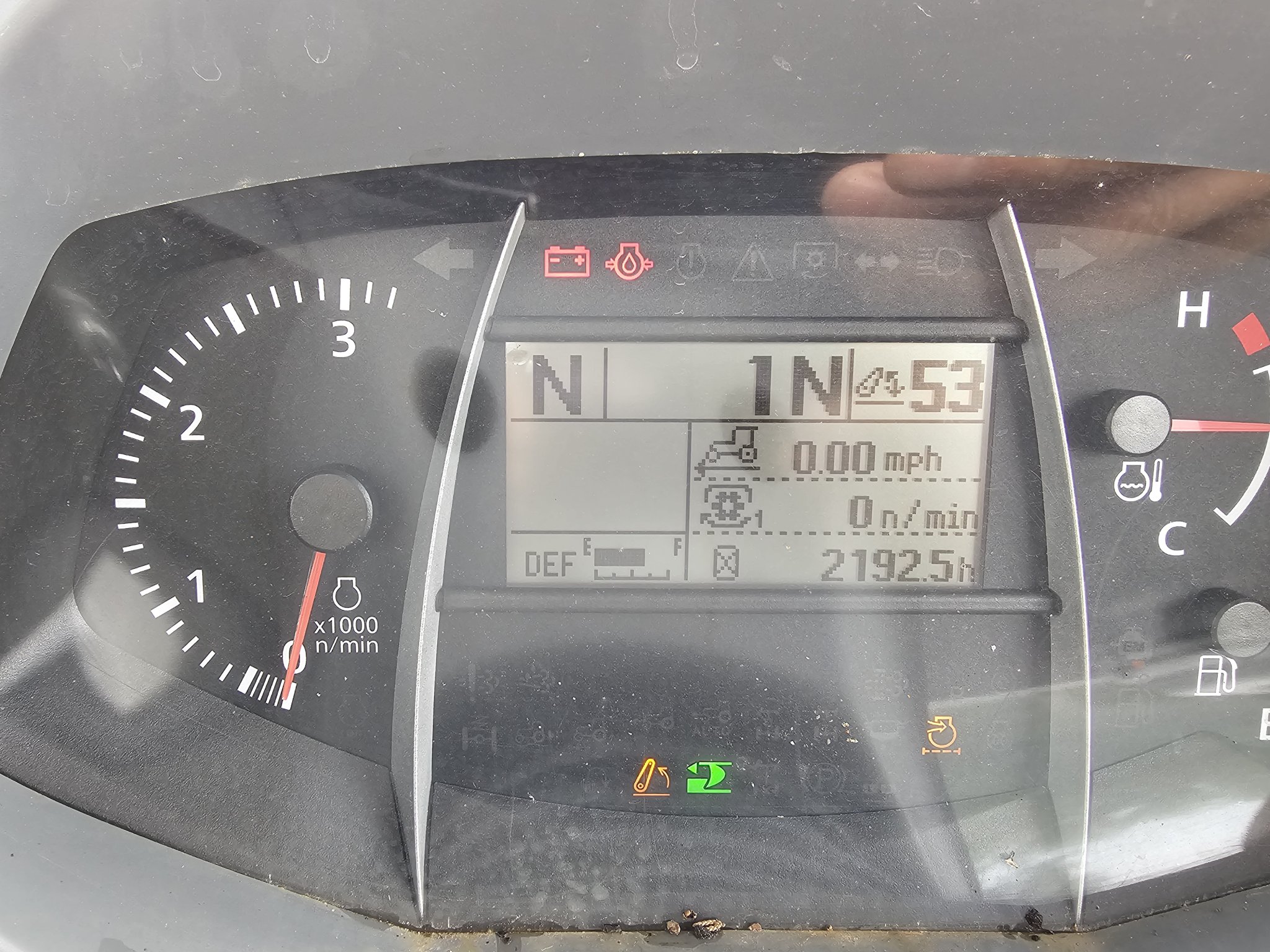

  • After several failed restart attempts, I noticed the battery indicator light was on, and further cranking became slow and sluggish. I see the engine oil pressure warning light is on (I initially mistook this for the hydraulic warning light, so I went to the local dealer, bought a 5-gallon pail of Kubota Super UDT-2, and topped off the hydraulic fluid). I showed the picture of my dashboard indicators. The dealer says the one yellow dash light not indicative of low hydraulic fluid but engine air restriction and suggested me to replace the engine air filters, so I bought a pair of air filters from the dealer and replaced them with new ones. The old filters appear to be just fine and clean to me, not dirty or dusty at all. After the hydraulic fluid top off, and replacing the air filters, I attempted to restart it, but the engine only cranked but did not start. I called the dealer back trying to seek help, left a message, but received no call back.

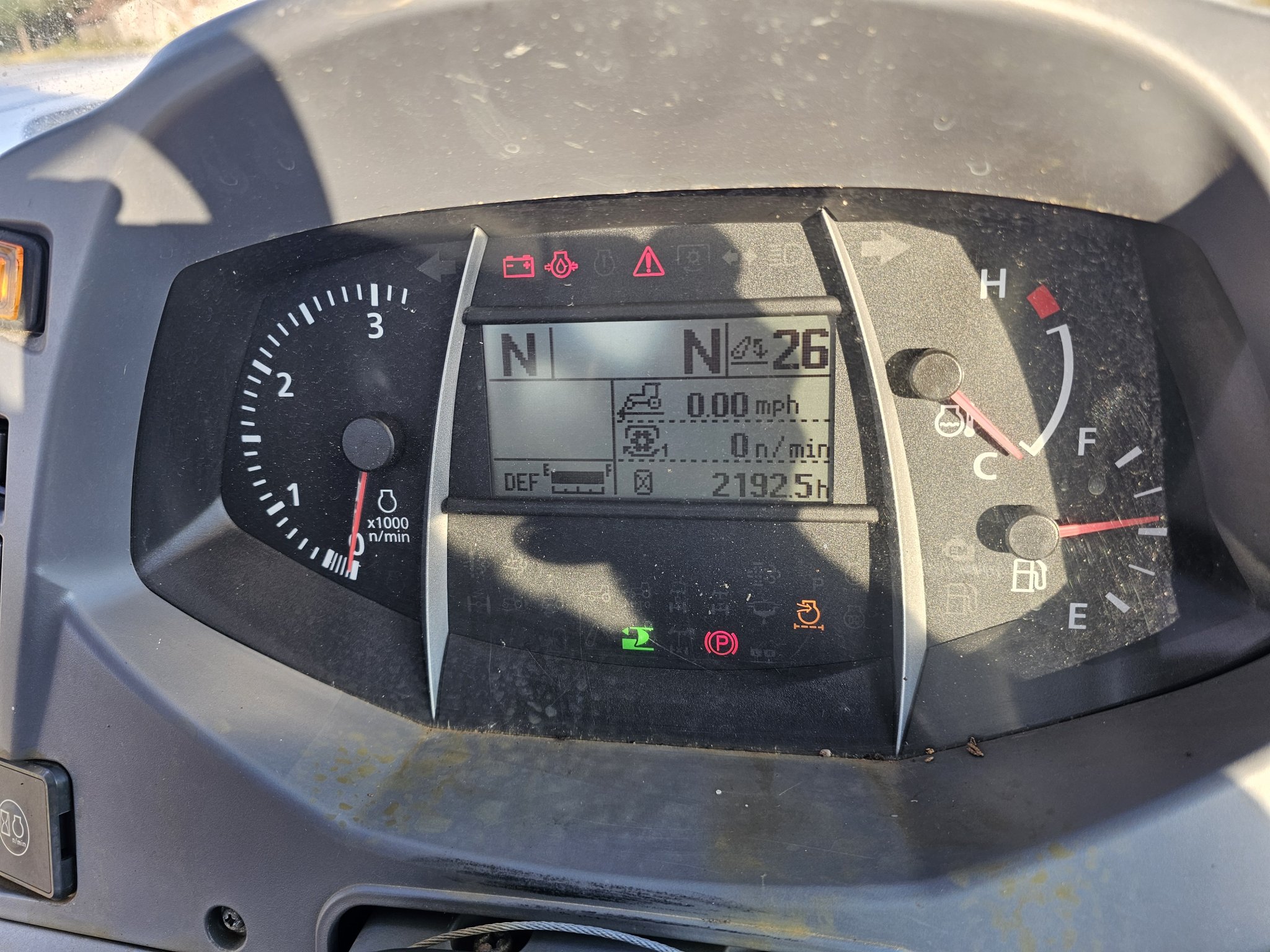

The fuel level is currently slightly above the mid-level—the same level when the engine died.
See the current dash display showing fuel level. I opened the fuel tank cap and verified the liquid level.

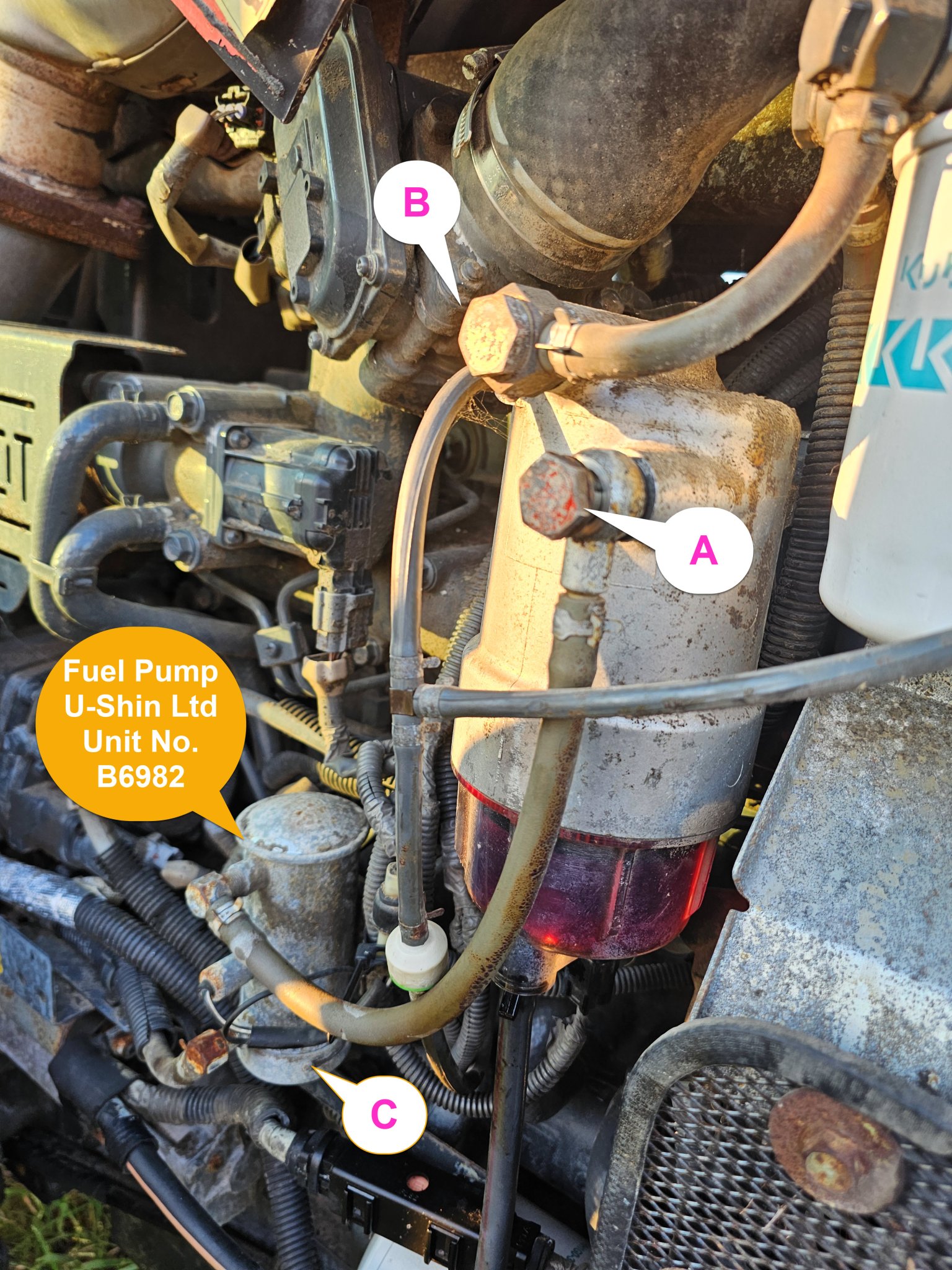

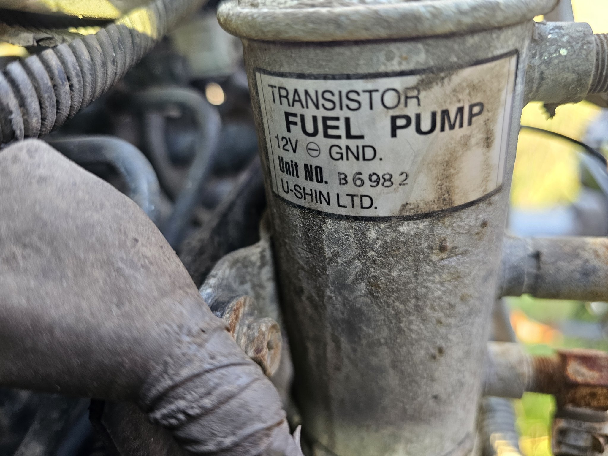

Fuel pump - yes, it has one, labeled "Transistor Fuel Pump, 12V, Unit No. B6982, U-Shin LTD."
I have no fuel coming out from the fuel separator bleed point (B) or inlet point (A) when these screws are loosened, although I can see and feel the pump vibrates when key is turned on (not turning further to crank)

I would take A completely off the separator and see if you can get fuel out of that line with the key turned to run position.
If you get flow there, then you might look at cleaning the separator housing. There may be some type of strainer or elbow that have a bug or grass plugging it up.
If you don’t get flow there, then put A back on. Move to the inlet side of that pump and remove the fuel line there and let it run into a clean bottle for a few seconds to see if it has good flow.
I am surprised that A does not leak since the separator is full.

Yes, absolutely tested with the screw "A" completely off, it looked dry when taken off—with the key on and the pump humming/vibrating, not a single drop of fuel comes out of the fuel line.

Look under the RH steps; you will see a water separator, which the fuel has to pass through it before it can get to the pump. See if it is clean with no obstructions.
In your picture, you have a cap on the bottom of the fuel lift pump labeled "C". If you unscrew the cap, you will find the pump inlet filter screen. It may need to be cleaned; no need to replace it unless it is damaged or rusted.
