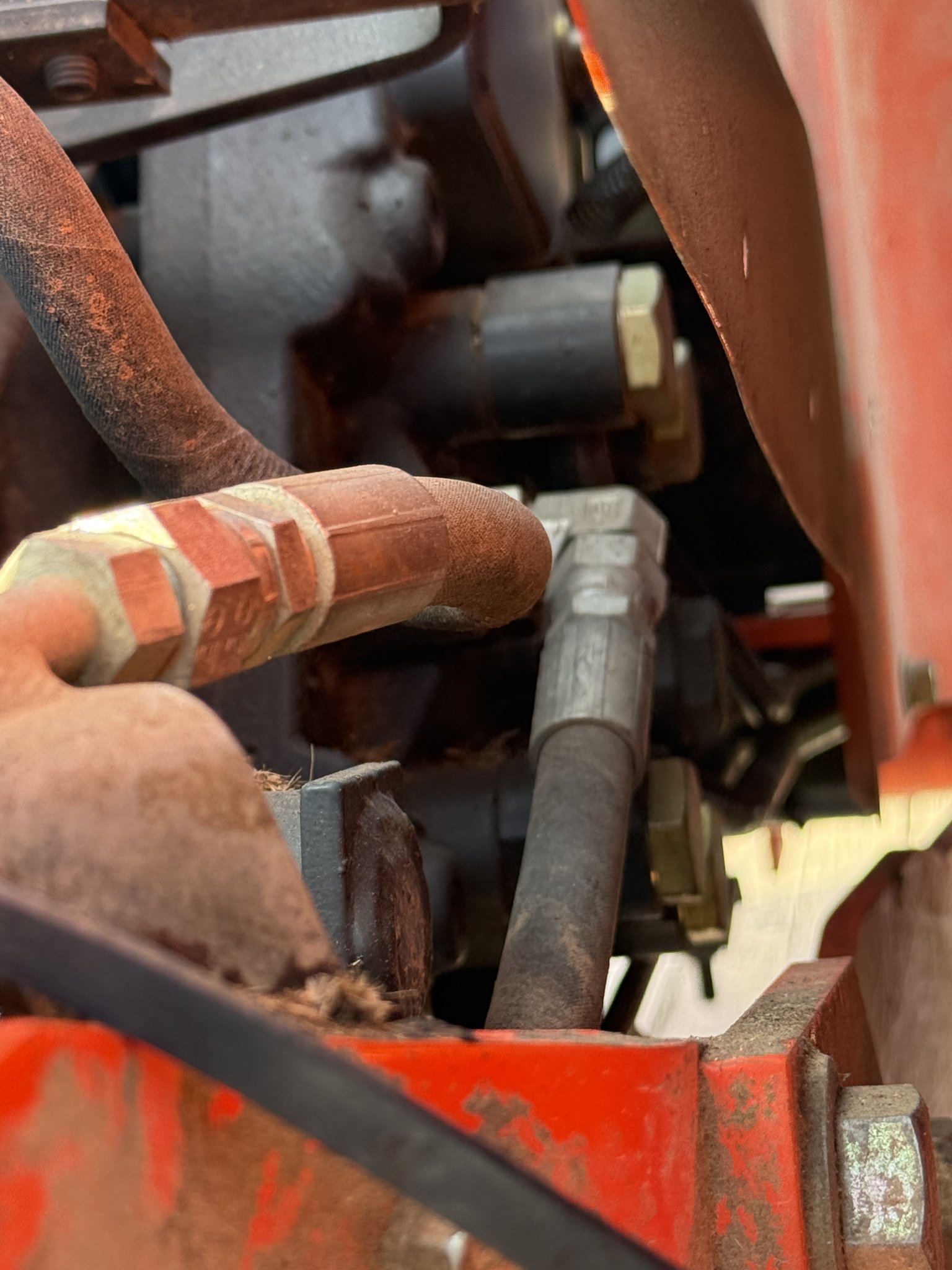

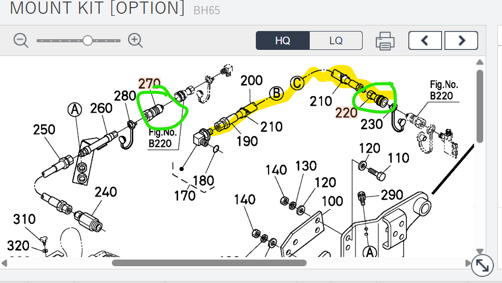

This would most likely be where your issue is:
I'm going to take those quick connects off and check and probably replace, I think the male is off centered so I think the poppet valve is messed up. I was thinking of taking the hoses off the loader control valve to check for blockages or broken o-rings - any suggestions or what to be aware of when I take those off? Does anyone have a schematic of the loader control valve? I thought I had found one online but there looked to be a lot of springs and o-rings and not sure it was correct.

In general, a sticking poppet for the quick release or a leak can cause these issus, correct? Im taking the quick connects apart on the loader and simply pushed in poppet on the yellow line in the female side and air spurted out and just flyid either pushed or just dripped out of the other 3 lines - so either air stuck or a leak….
12,381
7,065
Remove both halves and connect the hoses together with a fitting. That completely eliminares the QD. Then test operstion of loader and 3pt.

FIXED!! Thank you!! I replaced a few suspious quick connects going to the bucket and both male/female on the back hose - i think it was the male poppoet on the back hose not allowing the circuit to flow!! Appreciate the help! I should go back to the dealer and ask for a refund for the charge they charged me to “look at it” since they clearly had no clue!!!
