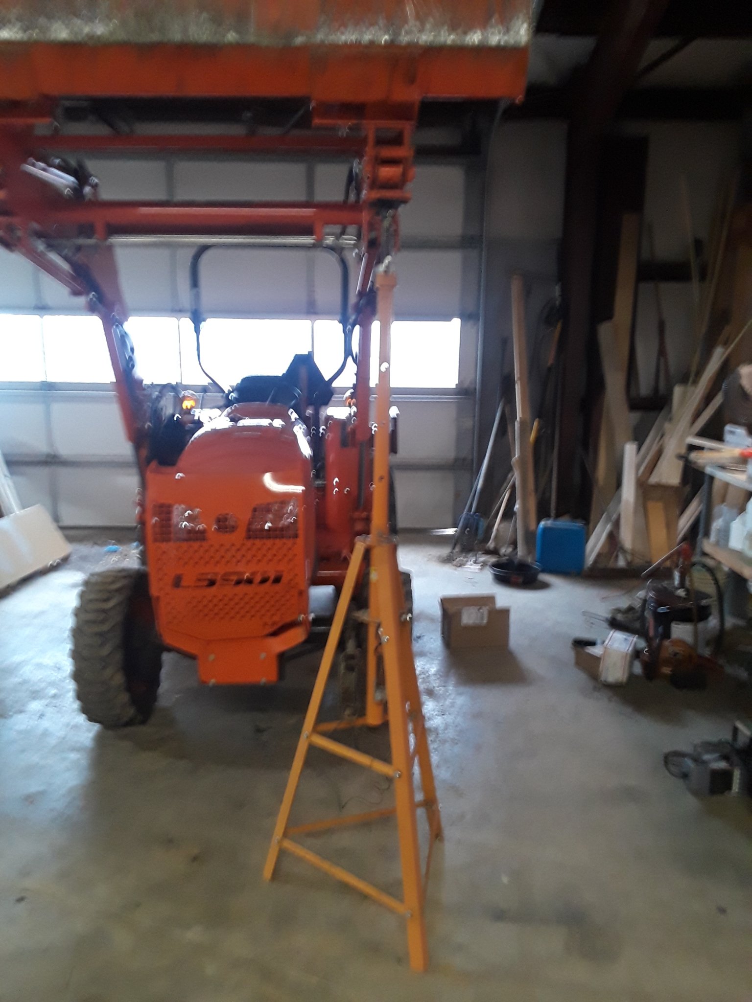

GrumpyFarmer
3,221
4,461
Regarding working under the loader…I am sure there are other options and cheaper ideas, but here is an example of cylinder safety stops. This or something similar to prevent the stored energy from crushing you if working under it would be ounce of prevention IMO.
10,847
5,958
3,215
5,350
