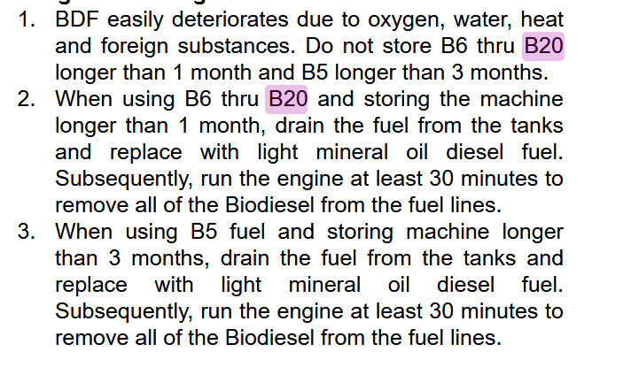

seems like we are seeing a lot of fuel issues these days as bio-diesel is creeping onto more yard sites. given we get petroleum only diesel delivered to our yards I never thought this topic would kick up such a hornets nest of hate. I just didn't know as I rarely ever get exposed to bio diesel.
So Kubota says no troubles using up to B20 but:
- replace fuel filter every 200 hrs
- replace all fuel lines every 2 years
- If using up to B5 drain fuel tanks and replace with fresh every 3 months, and if B5 to B20 is used then the tractors tanks should be drained every month! so an extreme keep your fuel fresh approach is needed. Must be hard for guys that don't run a tank of fuel a month or so.
our local dealer e-mailed me the following clip and I had no idea. no wonders so much fuel related problems are surprising guys.
I got schooled.

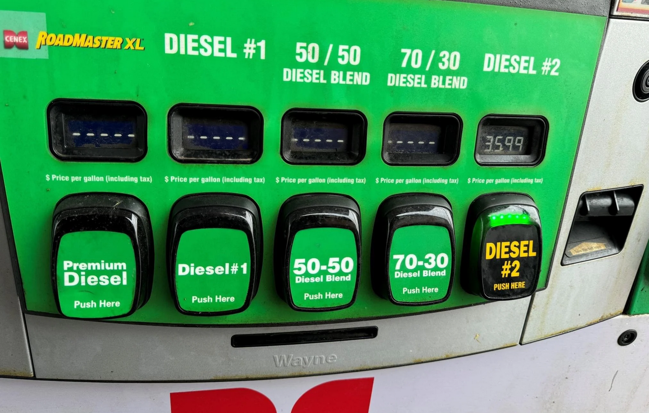

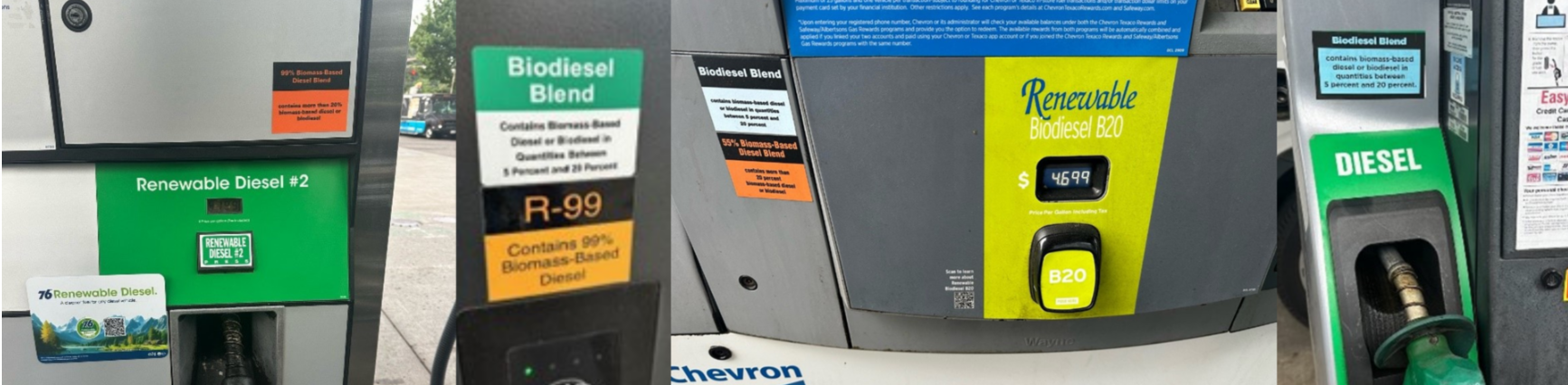

It can be confusing.
first pic is #2 with undefined bio content, next 99% bio diesel from this pump, then 20% from this pump, and finally these guys say somewhere between 5 and 20% but wont tell exactly. Confusing? My supplier has reg. and premium diesel, no bio to farms, blended #1 and #2 depending on expected temp. but won't say exactly.

Have yet to have this issue as I always pour my additive in, year round. After reading the post with the Kubota information, may change my fuel filters. Have owned mine 1880 for 3 years/210 hours and have not changed mine.

According to my supplier ALL diesel available in our part of FL is at least B5. He says they don't have to label the pumps at B5 and below.
that's good info for you to know for sure.
at least to me 5% means more than 5% or B5 or higher inclusion rate??
given the Kubota manuals, this gives you 1 month from its refining until your diesel hits its best before date. Pretty tight time lines for the little guy that doesn't burn a tank a month or is trying to store up some diesel for more than 1 month at a time.
now all this fuel related issues we are hearing about around the coffee shop makes a lot more sense. Its not whether a small diesel user / improper stores has had a problem but more like just a matter of time about when you will have a problem if fresh best practices are not being used..
Glad we get petroleum only diesel on our yard site which gives me a shelf life of between 1 to 3 years depending on how stored and what additives we use.
Never ever had these issues or worries pre 2000 when our diesel had 5,000ppm sulphur for lubricity and we didn't start feeding the bacteria with adding bio. Now the new world thats creeping up and getting worse every year means we need to take much more care or suffer the expensive consequences.

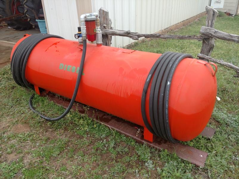

My diesel storage tank (for my ranch equipt) may sit for a YEAR or more before it’s re-filled.
I ALWAYS refill it using Biobor JF (anti-bacterial).
The tank sits outside in the sun and weather year-round. JUST LIKE the diesel-fuel suppliers tanks everywhere.
I NEVER have a problem with my diesel fuel.
(I used to refill it with off-road diesel…but when my OFD supplier , who WAS also my home propane supplier for 30+ years) became difficult….I quit PINNACLE …Forever. (Sorry company, never answers the phone, irregular office-hours, Adds stupid, un-approved “hazardous materials fees” and unexplained, unsupportable “surcharge” fees…to invoices.
I last priced OFD (UN-delivered, BTW) with them and they quoted $3.90/gal…when WalMart sells ON ROAD diesel at the pump for $2.95)
I loaded my tank onto the trailer and refilled it at the WalMart retail-pump.
Anyway….. I think there’s a lot of B.S. about diesel-fuel when it comes to “cetane” and “bio” and “algae”…. (there is NO ALGAE …EVER…in diesel fuel…no matter How you Mis-handle it.)
No 2 diesel is good for diesel engines, all you have to do is treat it with a well-known biocide and filter it thru a water-separator filter.
