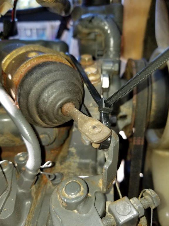

Well... it's been a while but I'm back with an update
Progress since last post...
I now have an operating Front End Loader on the Tractor!!! I haven't had a chance to put it under any load yet.. but she moves up and down and seems to do all the right things.
As per my last update, I was getting an engineer to fabricate the Loader sub frame after I made a template from MDF... it took him some time to complete and I completely underestimated the time (and therefore cost) of him doing this... He charged me 22 hours to fabricate the subframe and also create a Hydraulic Diverter Block so that I could drive the loader...
Anyways... you can see from the pictures the net result... I still need to take everything back off the tractor and paint... but given the tractor is not in the prettiest of states, I'll get around to this at some point.
Things I've learned...
* Engineers are expensive
* Hydraulic Hoses and Fittings are expensive
* The Vapormatic Hydraulic Control Valve that came with the loader needed a $1 part to convert one of the outlets to power beyond port.
* The loader definitely needs a "return to tank" Line
* Make sure you get the "return to tank" and "power beyond" plumbed the right way... or else you have no 3 point linkage hydraulics (and surprised I didn't blow anything)
* Don't run the tractor out of diesel while troubleshooting why the hydraulics are not behaving correctly!
(Plus side is, I now know how to bleed the fuel system on a B7100)
