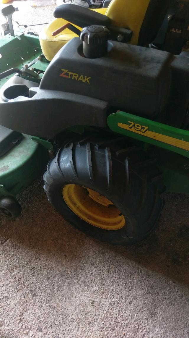

SRG
B8200D 4WD........ JD 870, FWA, 300x FEL.......... JD 797, 72" Z-Trak
Jul 15, 2017
490
N. IL
Just my 2 cents;
I'd love to have a zero turn but have been warned by countless people that it wouldn't work very well with the hills that I have. If your property is fairly flat, go for it but if not some more research my be in order.
How steep are your hills?
I went from regular old turf tires on my ZT to Carlisle AT-101's and it made a world of difference when side tracking my ditches.
