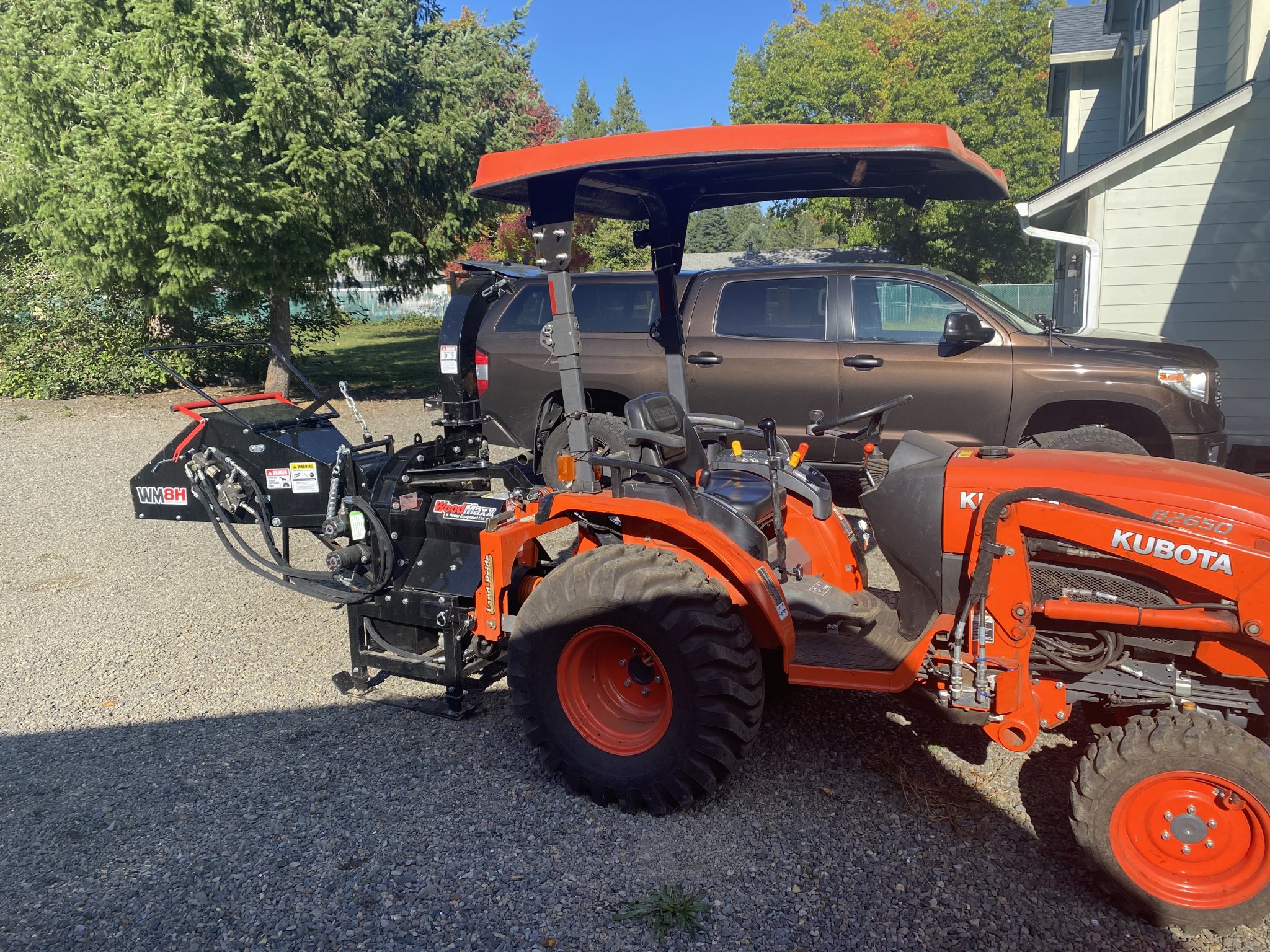

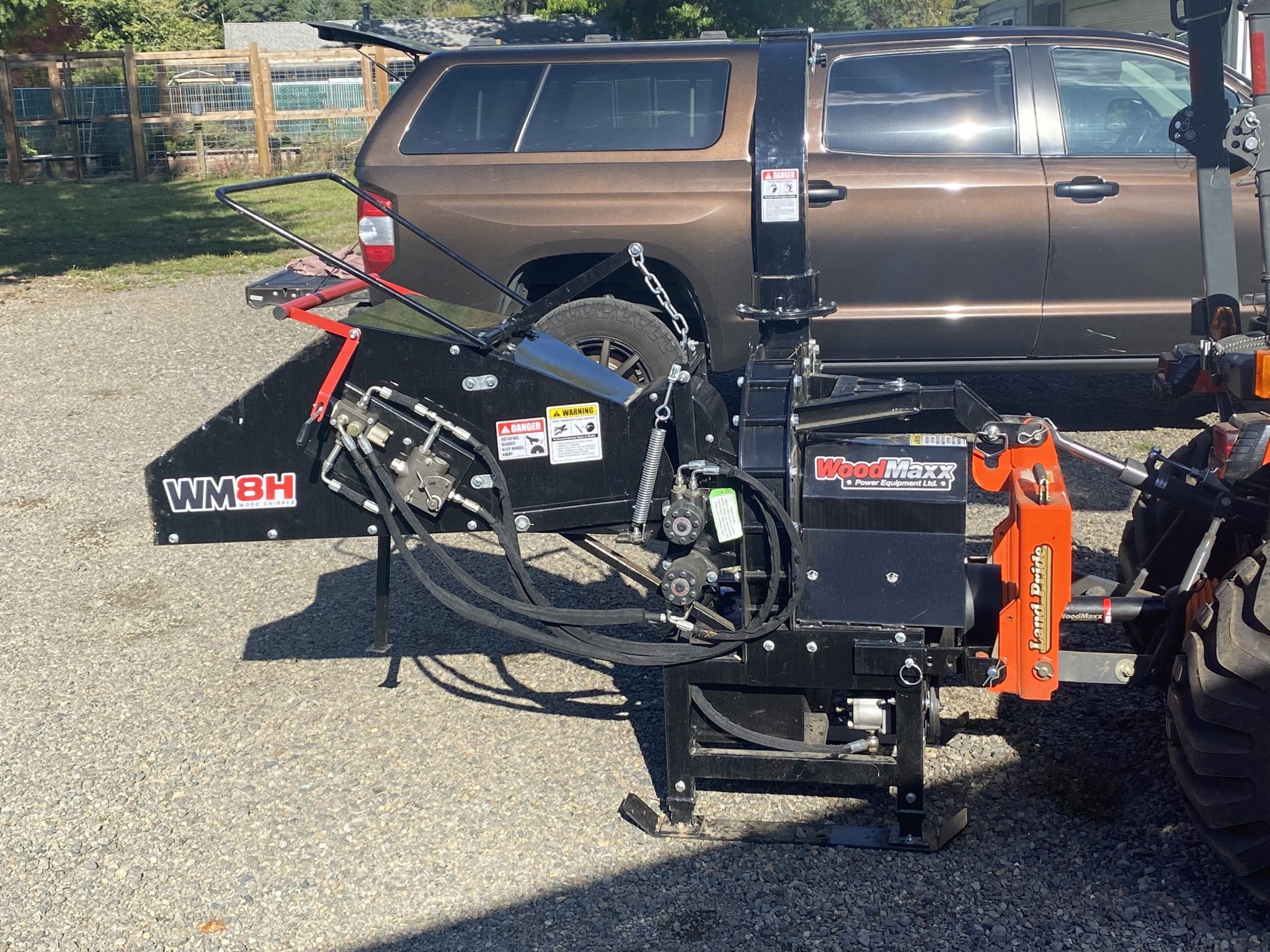

Alright! Finally had some time to get the new-to-me chipper hooked up and off the trailer his afternoon. Having a high school daughter in volleyball is turning into a full time gig…

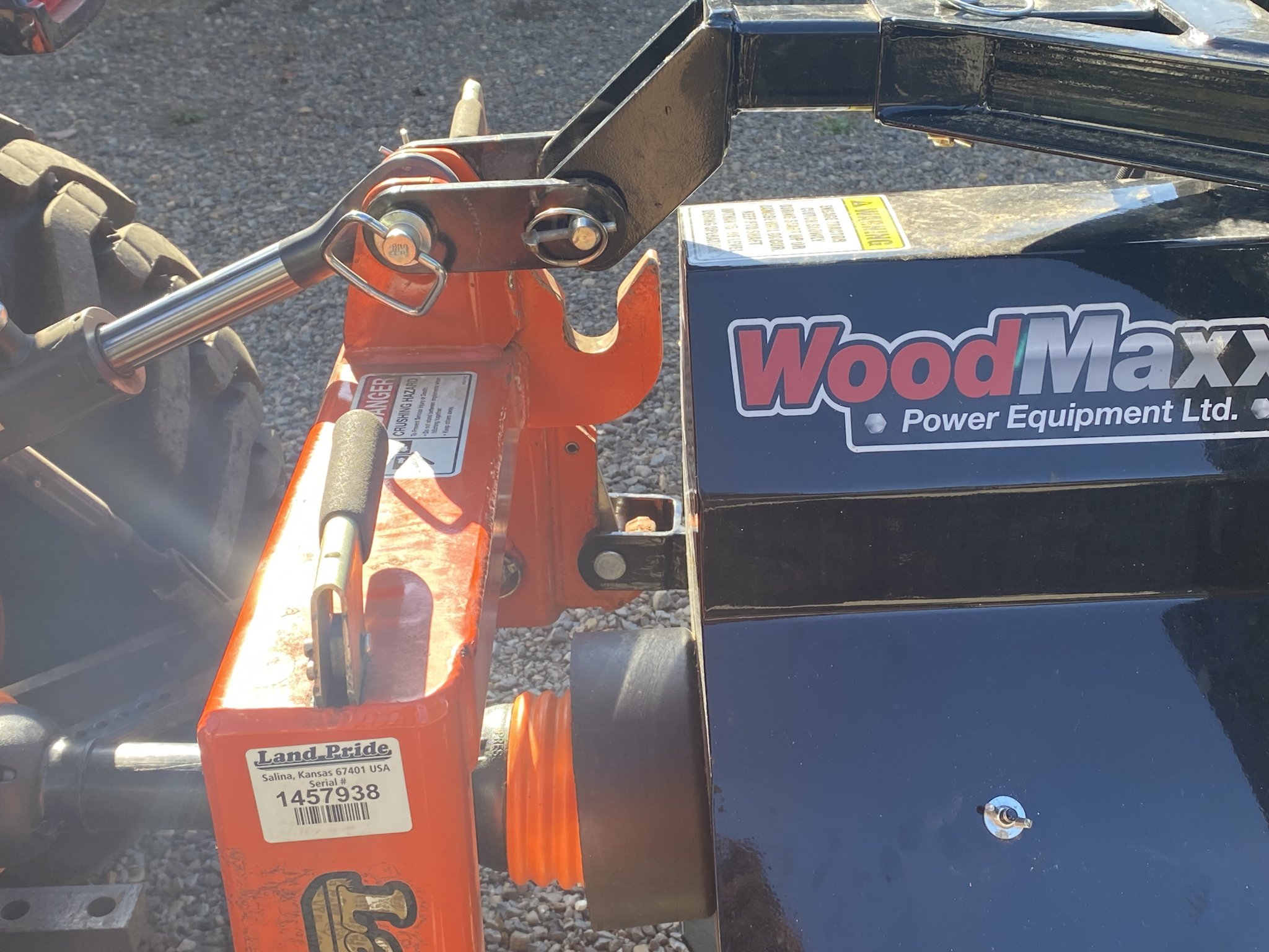

Like my WoodMaxx flail, a Land Pride QH-10 does not work since the top hook isn’t adjustable. Also like my flail, it’s an easy fix with a simple shackle from a leaf spring….
Since I have to hop off to attach the driveshaft, it’s just a couple seconds to put one pin in. I leave the shackle attached to the top link pin at all times. I’ve been using this with the flail for a few years now with no issues.
Got the driveline cut to length, as it was about 2.5” too long with my 3-PH raised fully. On the ground is where the shaft could be its longest, and I have about 5” of slip shaft engagement. Should be fine.
This thing is like new! I pulled the plastic sleeves off the hydraulic hoses so I could spot any leaks that may pop up in the future. Hoses look as fresh as day one.
For startup, I rev the motor to 1,400 RPM and hit the PTO lever. It certainly bogs the motor for a moment, but it recovers quickly. Much under 1,400, the motor stalls.
Time to go find some sticks!!!

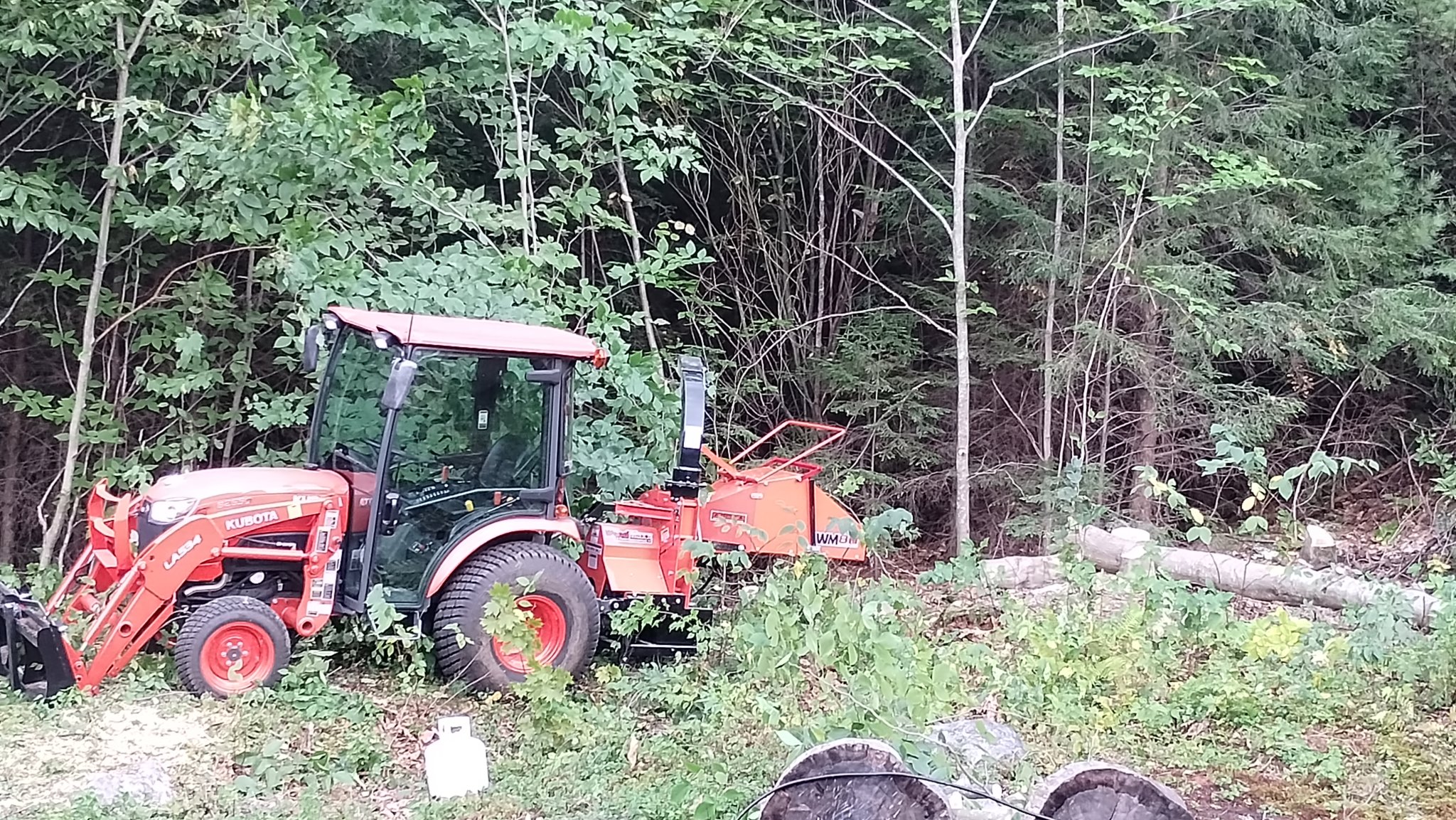

Looks like the newer ones come in black
now...I used mine for several weeks this spring cleared along my boundary stone wall...works great.
