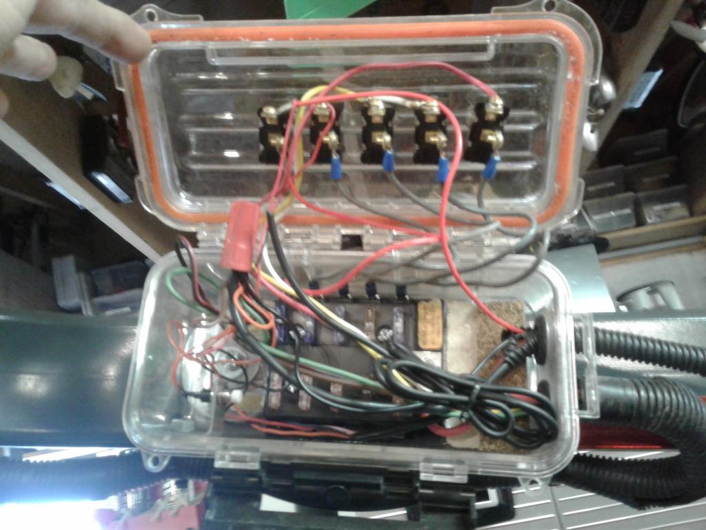

I have a trailer mover with winch attached- winch has 50 amp fuse. Went to Walmart, bought wiring kit for power amp. The big one for heaviest amperage draw. Replaced 80 amp fuse with 60. Added 12 volt power connectors (forklift shop cheapest source) did same for jumper cables (can jump car or tractor).

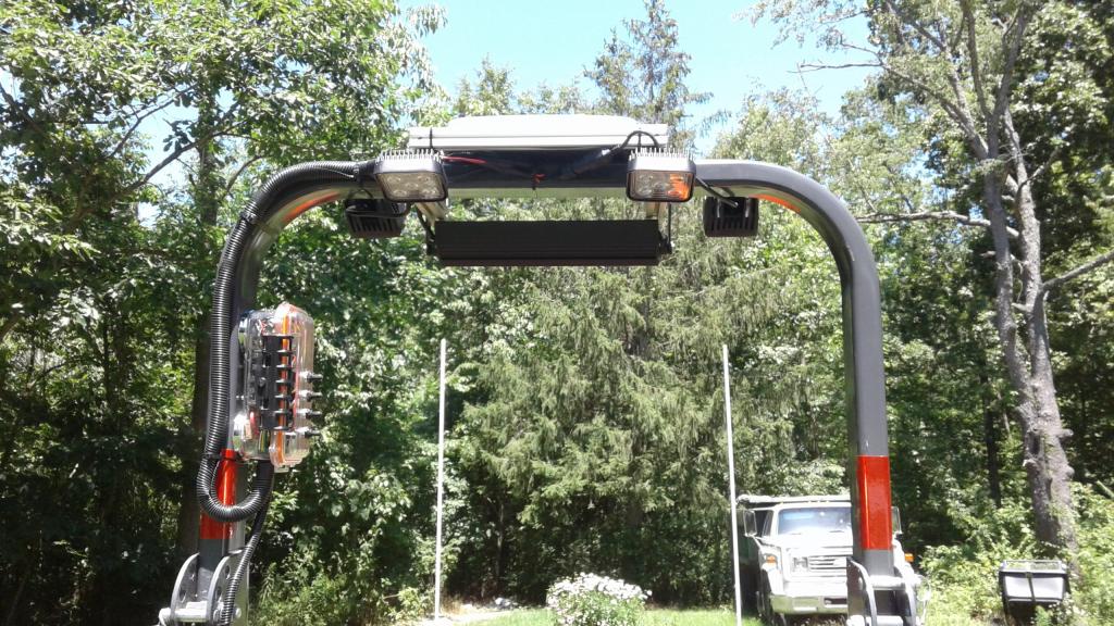

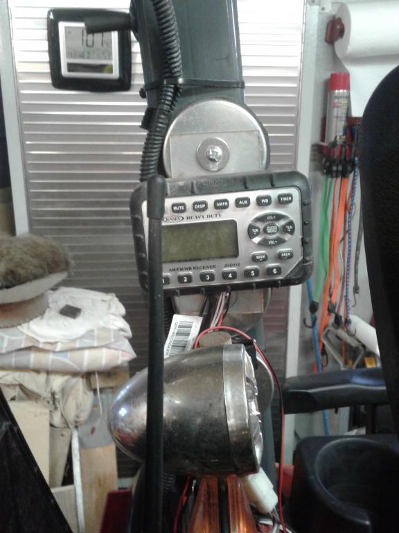

Made own ROPS bracket, added 4 sets of LED lights + radio, waterproof box with fused distribution block inside.
