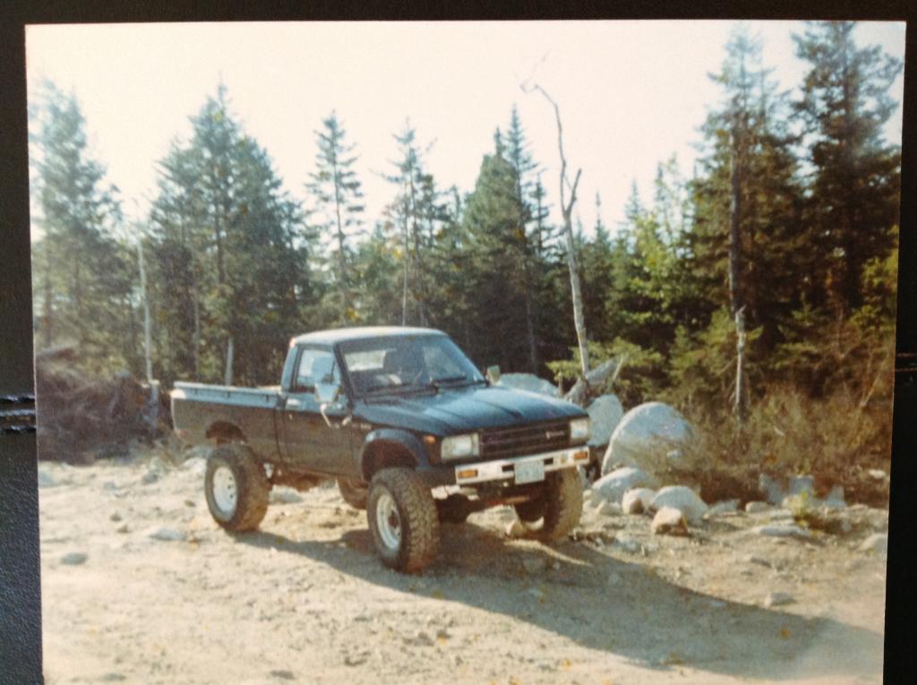

I've owned many Toyotas both cars and trucks even built my own years ago. It turned out to be an 81, 82, 83 and 1988, bits and pieces from each year. I've never said a bad word about any of them. Wife and I spent many hours 4 wheeling back then with the truck I built.
That would be fun! Both the building and the 4 wheeling!
It was a great time but expensive. I've always said I'd be a fairly wealthy man if it weren't for my addiction to gasoline. Just heading out to pull the bearings out of my boat trailer now so you're welcome to tag alone and pack the bearings for me. :D
