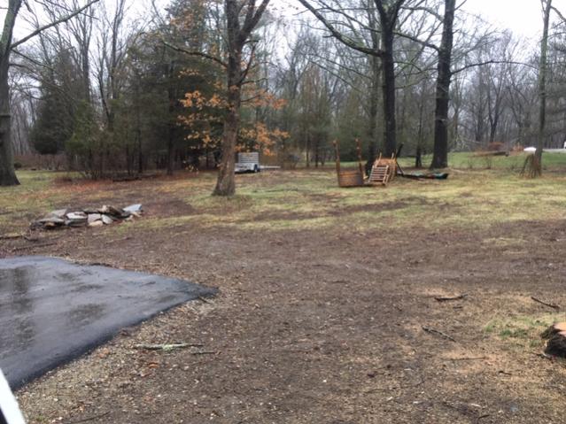

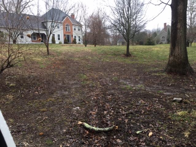

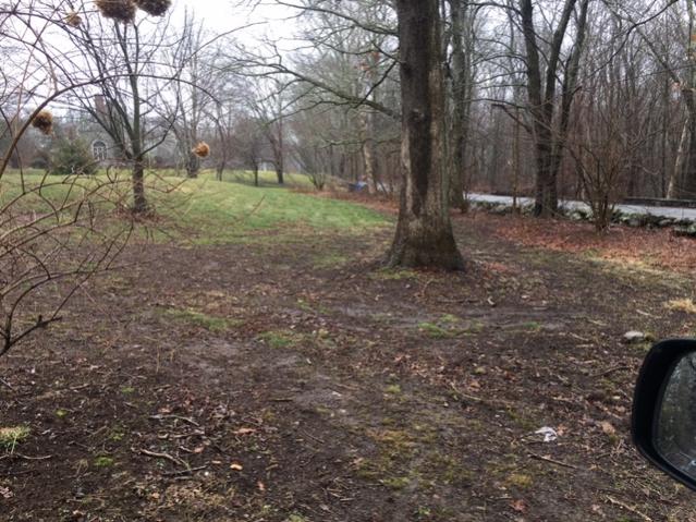

I am 1 year in to this property and need to acquire a new mower for spring. I almost pulled the trigger on a BX2380 when I purchased the property but decided to hold off for one year to get a feeling for the lawn. I can no longer wait as my H/O grade lawn tractor is on its final leg.
Property was vacant for some time and the lawn paid the price. There are several voids from where trees were removed that need to be filled, it is very bumpy and needs leveling/grading in some areas, has several areas in need of topsoil and hyrodseeding, and all the mulch beds removed and redone.
Lot is 1.5 acres. Also has 15+ large oaks, elms, maples which drop leaves in the fall like crazy and a few which have exposed ground roots, bumpy soil/grass surround cover (rough stiff!).
Would you suggest a BX MM and FEL route or a ZTR. Also, I expect a commercial ZTR would pulverize the leaves better than my current mower or a BX (neighbor has a Scag that eviscerates a shocking amount of leaf cover versus my other neighbor’s Yanmar SCUT.
If I ever get the lawn where I want it, then a ZTR would be a no brainer. That said, I think a BX would allow me to bring in yards and yards of topsoil to repair the areas, mulch, etc and the mow cut quality and leaf mulching would be acceptable until I get the grass where I want it. Additionally, I am simply concerned that a ZTR purchase now over a BX will inhibit me from the lawn ever getting where I want it without hiring out which will add up $$$ quickly.
Any input is appreciated.

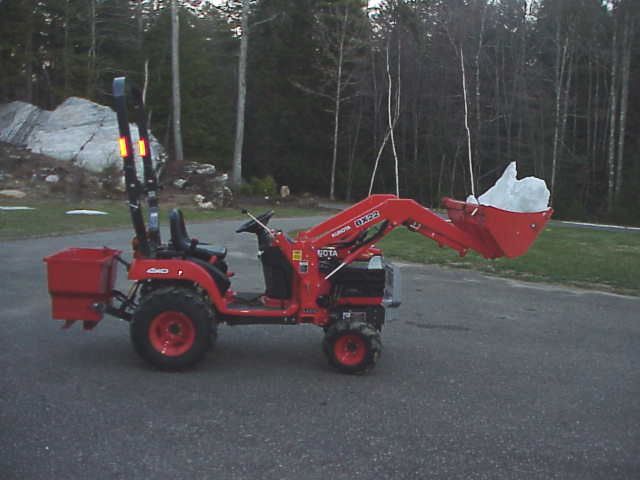

I agree with what others have said, but with one exception. I would buy a BX Tractor/Loader/Back Hoe machine. I have a BX22 since 2004, and it is not that I use the back hoe that often, but when I need it to dig, I have it available to me, rather than having someone else getting paid to do what I can do myself. The BX back hoe isn't that powerful that you are going to be digging out large tree stumps, but when it comes to putting in fence post, new trees or shrubbery, etc., it can't be beat. The back hoe comes off easily and quickly, and doesn't take up that much room in the garage when it is being stored.
As for cutting the lawn with the BX, I have a 60" mower deck, and cut about 2 acres with it. It is not a fast machine for cutting, but it does a nice job, as long as you keep the blades sharp, and the underside of the deck clean of dried grass. I also have a bagging system, but don't use it often, since it fills too fast, and dumping it is a pain. If you are going to be cutting the grass often, then I would suggest that you consider the next generation of BX machine, the BX23, since they improved how the loader detaches. The BX22 series, the loader valve comes off with the loader, and then you have to detach it from the loader and put it back onto the machine, if you want to use the loader valve for either a snow blower, snow plow, or sweeper. I have all of these attachments, so this valve issue is a negative for me and my machine. If I had it to do all over again, I would have waited another year and bought the BX23.
Considering that you live in the Northeast, unless you have a plow truck, you should consider purchasing a front mounted snow blower at some point. It will make quick work of cleaning your driveway.
Below is a picture of my machine that was taken back in 2004, before I acquired BX snow moving equipment. I was moving a snow pile off of the lawn and putting it at the edge of the woods. The weight box is an important item to have if you are going to use the loader.
