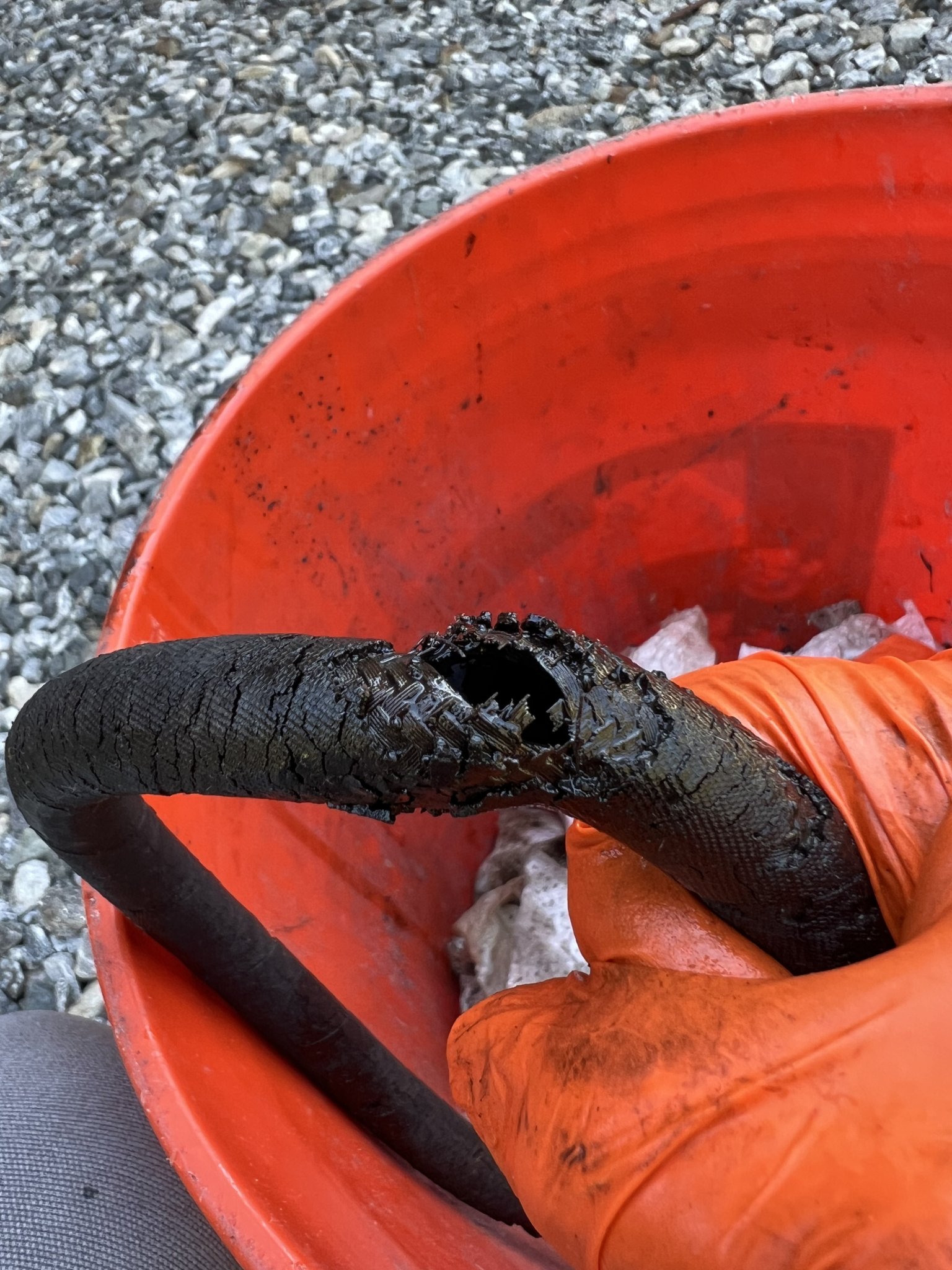

This one let off under some pressure. Sounded like a firecracker, kinda caught me off guard!

Not surprising, for 25 year old TLB.
Perhaps you need all new hoses?
Yea, most on the FEL are original. I’m amazed they have lasted this long. The rubber outer coating has been cracked for years. If water gets in it rusts the braid, then after a while you get what I had today. I threw a old longer one I had on to finish what I was doing. But full replacement on the FEL will be in my future. I have been through the BH already.

My L48 TLB lived the 1st 13 years of it's life outside.
It lives inside now, and I don't plan new hoses, until the first one goes.
Some slight cracking, but they all do still appear to be quite serviceable.
Replacing your BH hoses must have been quite difficult/frustrating.

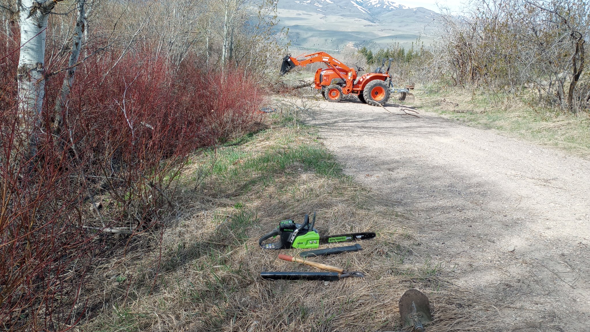

This weekend, doing some clearing of new growth around the 3" supply line that runs down the mountain 1/4 mile to my hydro electric generator, I set the 80 volt Greeenworks well out of the way, of course! 30 minutes later, backing up, I was surprised to feel the rear of the tractor lift up, I had backed one (filled) wheel (including 150 pounds of weight on the scraper blade) up on top of it. "Darn it" I said, and drove off it, already thinking I'd immediately order a new one and just try and forget it wasn't the original I stupidly ran over. Just for grins, I picked it up and hit the trigger, no joy and no surprise. I set it back down and went back to tractor work, right before I took a break and was going to eat lunch and order a new one, I tried it again, still no joy. Then I remembered it's panic bar, pulled it back, and it turns out it was 100% unharmed. Where the rear tire rested, was directly on top of the battery case, and it supported what had to be about 800 to 1800 pounds (just a guess) with NO damage. Even better, the same day, while bushwhacking along the creek, I finally found my 60 volt Greenworks chainsaw I had misplaced last fall, searched for, and
never found. It had wintered over, while the battery was in my Greenworks lawnmower. I pulled the chain, soaked it in gas then oil, and it too is totally unharmed. I think I have a new career as a Greenworks spokesperson.

I have a little Greenworks 16" saw.
Absolutely perfect for this old guy!
My Stihl has been resting comfortably on a barn shelf, since the Greenworks arrived, 5 years ago.
Perhaps you should buy a lottery ticket?

I've had that same 80v saw for the last three years, I don't think I'll ever own a gas powered saw again, that thing is a beast - and you can buy a new bar and chain for less than $30 (together) - fantastic to hear it survived a drive-over.

It wasnt the worst job I have done. Messy, but doable. I don’t know if the 48 is like the 35 the way they route the hoses down through the swing joint or not, but that’s one of the tougher aspects is getting the cylinder end back in place with all the hoses fighting for room in there as well.

I had to replace three hoses on the BX25D backhoe when I owned it and that was at around the 3 year mark. I bought it new and the tractor was kept in a barn and out of the sun, but the lack of humidity up here does a number on rubber products.

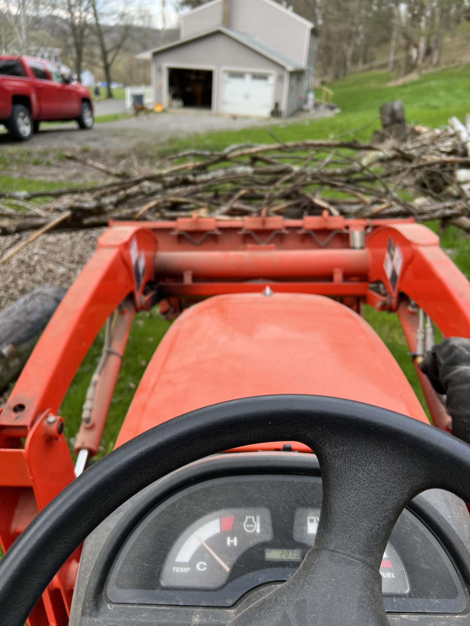

Not much. Working on seasonal transition still. Target needs to get ready to mow shortly, but it’s not an emergency.
Took chains off, picked up a few downed limbs.
Put sharpened blades back on and drained the gearbox of the mower deck.
As it’s steep (look to the right of the house), I prefer not to mow with the loader on, but will likely do so once or twice this year before I take it off for the season
Weather Channel is saying rain mixed with snow tomorrow, but we won’t have any accumulation.

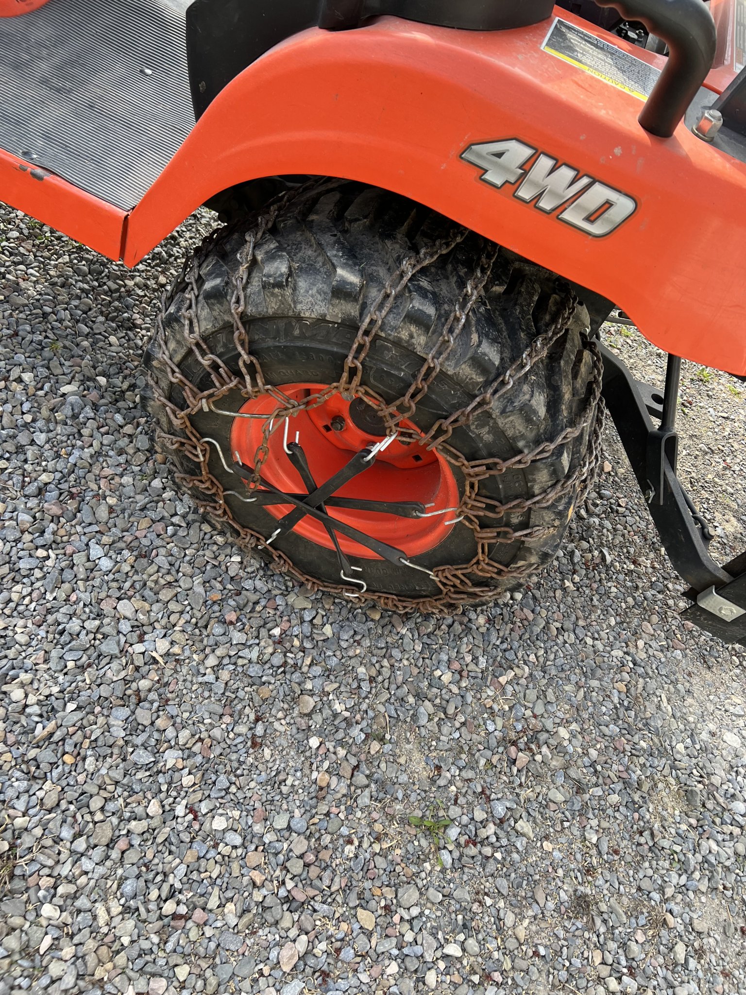

For BX guys, I’ve run these chains for 11 winters without wheel spacers. It’s tight in the wheel well, but if you’re careful it’s not a requirement to have spacers.

Very similar, I suspect.
