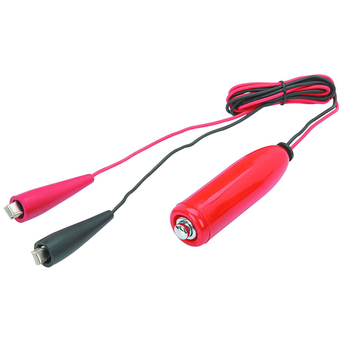

Or better yet install a switch :unsure:
Well mechanics often DO have a switch on jumpers of some form or another, either homemade, a ‘starter switch’ which is basically a pistol grip and trigger hooked to two long jumper wires, or a power probe which can be used as such.
But people who don’t diagnose things for a living probably dont have the need for such things often enough to go out of their way and buy or make a ‘real tool’ for rare tasks. So im just saying if one wants to jump something repeatedly for testing and doesnt want to pockmark up the surfaces or make a ‘real tool’ they can just make the final connection on a sacrificial bit of copper wire rather than on their tractor. If anyone does want to buy a premade tool you can get a ‘starter switch’ or power probe for about $20 on the cheap end.
9,213
4,805
A remote starter switch at Harbor Freight is $12. I would imagine you can still buy one at just about any auto parts store. In the old days when we adjusted valves and set timing just about every shade tree mechanic had one in his box.
