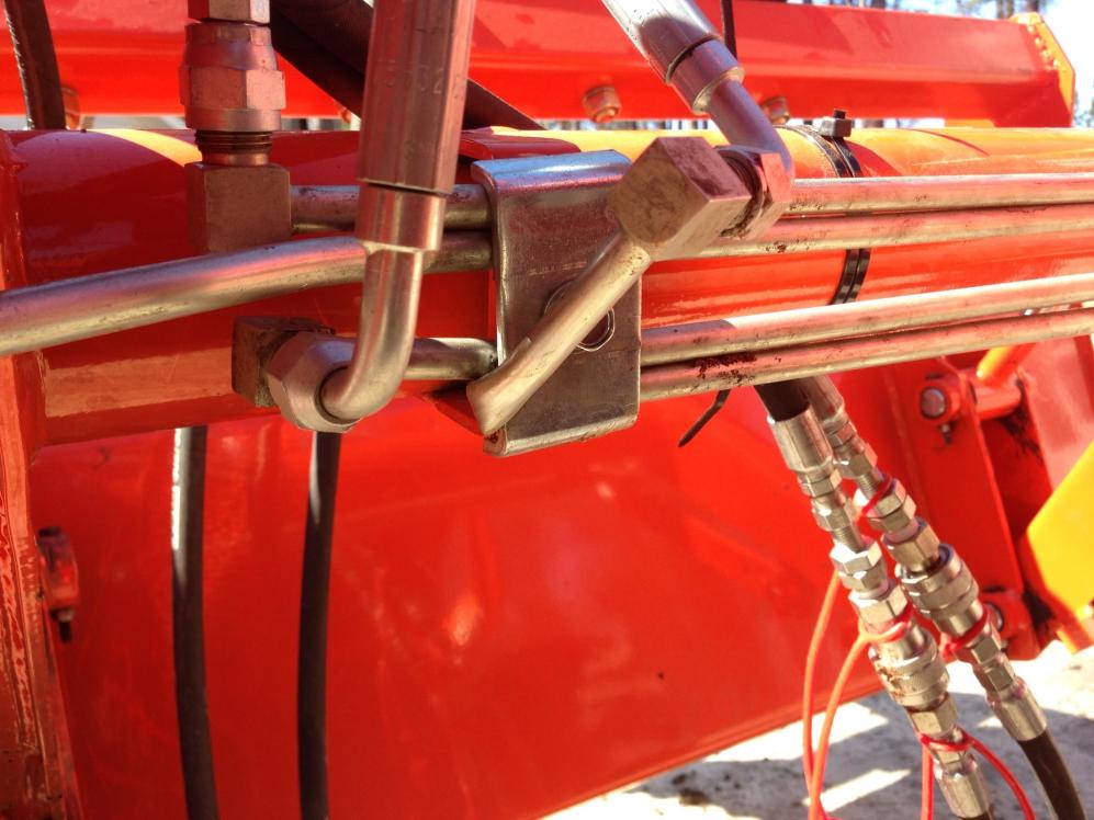

Had my first "OOPS" yesterday , luckily it didn't put me out of business and I was able to finish clearing some. Had a root roll up under the bucket and before I could stop it caught the one of the loader tubes and bent it back. Glad it was only 1 of them, but I'll bet it's the most expensive one of the 4 .
That will be a $60-$70 lesson learned and hopefully I won't do it again

I would replace it with a hose myself.
Yea, if it wasn't brand new, I'd probably cut the tube off, flare it and add a new piece of tube with a couple fittings but being the first I'll probably order a whole new tube.
