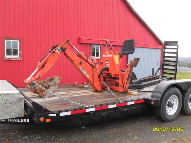

Went and bought the backhoe today. Have to do some mods to the subframe but Wallenstein says it's easily doable with a bit of welding. Now I have to get my tractor plumbed hopefully this week for the rear hydraulics
Can anyone give me some insight on plumbing my tractor ? Some have suggested rear remote and some have suggested the flow beyond method? I don't really understand the difference between the two , both will supply me with the hydraulic hook up I need to run the backhoe correct? One is quite a bit cheaper i'm being told to do, why do people go with rear remote if this is the case?
I can't help on the plumbing as mine is a PTO pump driven model, but I thought I'd throw out a mounting suggestion if you don't have that all ironed out yet. I bought a well used BH with a subframe for some unknown model of tractor so like you I had to do a fair amount of work to mount it on my tractor. I stumbled onto an online list of installation/user manuals on Woods web site. I found a manual for the Woods subframe mounting bracket installation for my exact tractor. The pics in the manual showed exactly how the subframe and brackets were to be mounted, all I had to do was build the brackets and modify the subframe to fit.
