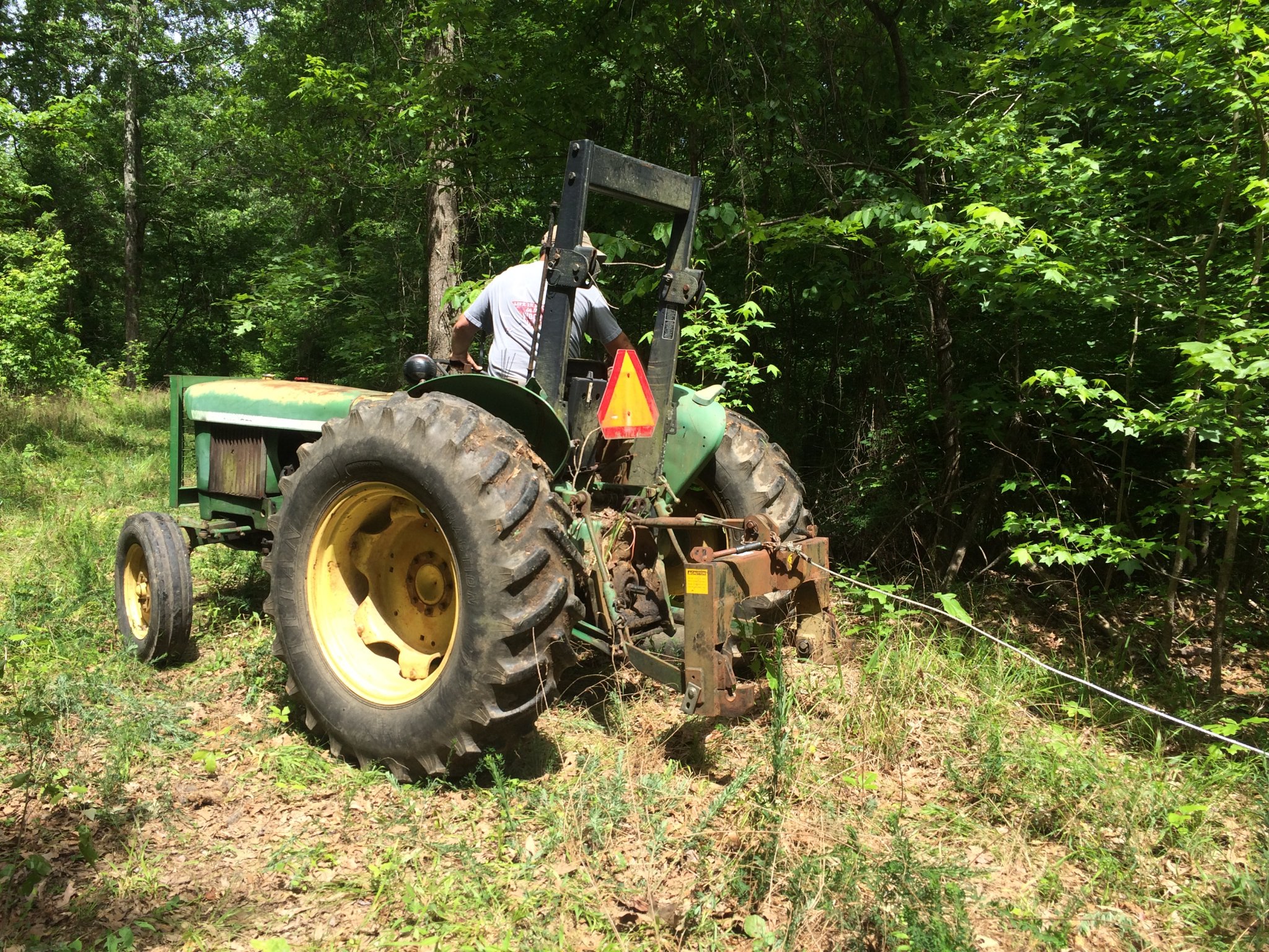

No, actually it was a very smooth and controlled motion. There were no pictures of the actual rigging because we were sorta busy at the time.

I just wouldn't pull from the top of the quick hitch.
I understand your concern but at the time that was the only center attaching point that we had. (There was no drawbar on the JD.) He lowered the lift arms and as stated, we were using snatch blocks which halved the pulling load and the up-righting went smooth and easy. Actually we were amazed at how simple it was.

I understand your concern but at the time that was the only center attaching point that we had. ..... He lowered the lift arms and as stated, we were using snatch blocks....
I see and I noticed the JD didn't have a draw bar. You exercised due caution and it worked easily enough for you.

But now for the hard part. It would not go as it was so we cranked it up long enough to lower the bucket and shoveled the dirt out of the bucket.
John Deere, two blocks, and the cable attached to the chain that went through the tire and around the axle. It rolled back over very gently.
Don’t mean to be overly-critical... but there appears to be TWO things questionable in this thread.
The earlier post by the OP was “unless the ROPs are down do NOT put on a seat belt”...which I read to be stated exactly Wrong. For protection, IF the ROPs are down do not put on a seat belt. If the ROPs are UP ...WEAR that seatbelt.
The SECOND suggestion I’d make is NOT to pull anything heavy as the picture shows because:
1-It is being pulled via the 3-pt hitch from a point higher than the rear axle... which can pull the green tractor OVER on top of the operator.
2-A cable is being used which, should it snap, can act as a WHIP and come back and CUT the operator...perhaps even FATALLY. A cable should be weighted with a heavy tarp or carpet etc to prevent that.
3- (And THIS suggestion pretty well addresses the first two): The green tractor should have the cable run BENEATH the green tractor and it should be pulling the load with the green tractor in REVERSE. This will place the front of the green tractor between the operator and the load, and a broken/snapped cable will be less likely to strike the operator, and the green tractor can not be overturned onto the operator because the cable would be BENEATH the tractor.
[snip]
I read it that way too and responded to it the same way. Actually said something like that is the worst advice I ever read here or elsewhere...
Then on re-read I came to the conclusion the poster forgot the word "then". IE, that he meant "if the ROPS is down THEN do not put the seat belt on..." Not trying to put words in that poster's mouth though...maybe he can respond himself...
