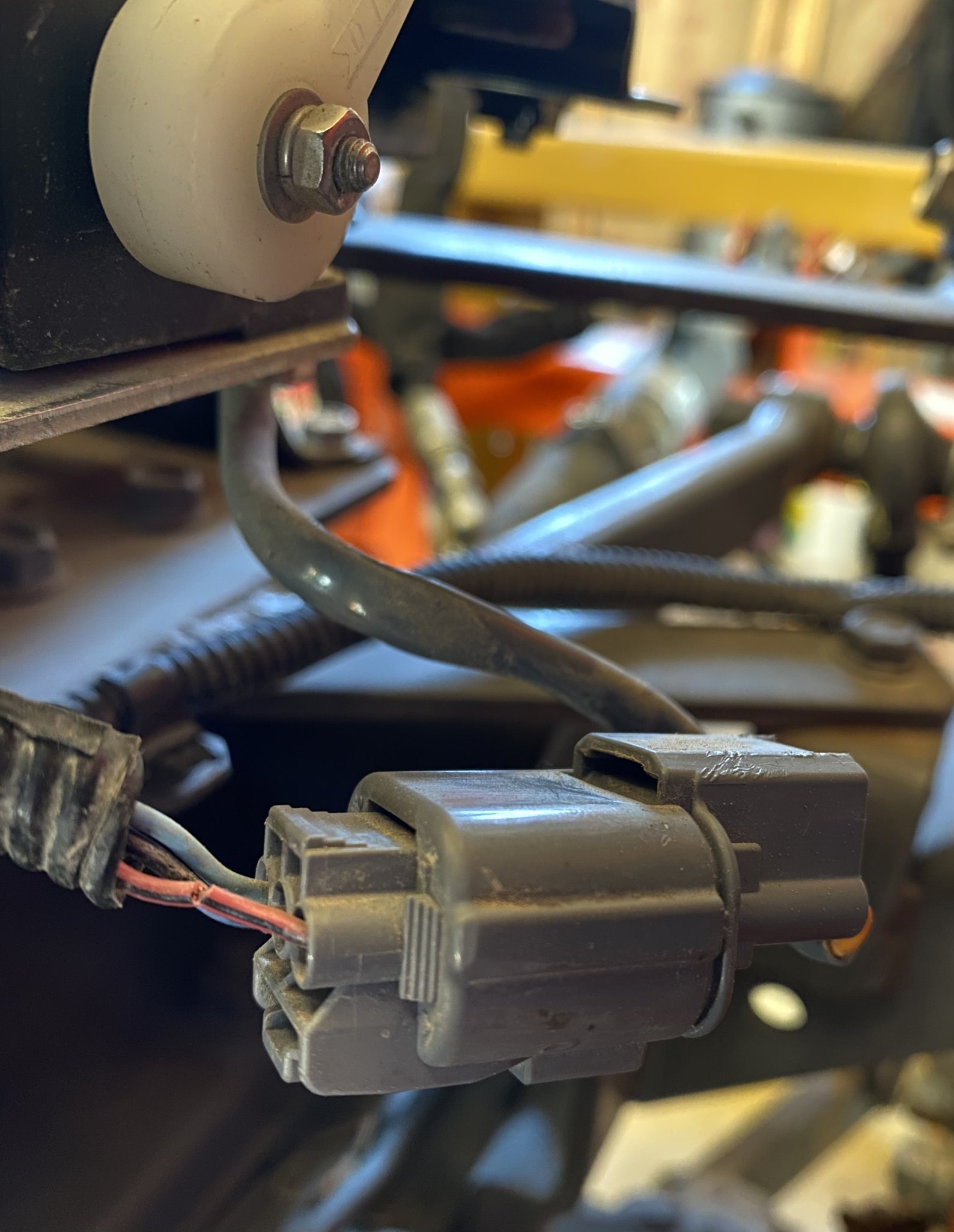

So with this post I’d like to not only bump this simple test back to the top, but also wanted to express my sincere gratitude to lugbolt for his many contributions.
I was headed out today and intermittently the engine would just try to cut out, especially if I would try to stomp the HST pedal as the hill increased.
So as I’m sitting out on this road (not stopped, but just barely creeping) as log trucks, state troopers, and school buses are driving around me, I’m wondering first if it’s an engine issue or a fuel starvation issue or the like.
But sheepfarmer (thanks to her as well) impressed upon those of with common rail engines, we need to be almost fanatical about keeping water away from our diesel—so between my stout Mr Funnel and a set schedule of fuel filter maintenance, along with a shot of Bio Kleen now and then, made me think a little harder—and remembered I had filed this one away for a future look.
The test itself worked flawlessly—and when I got to the seat switch itself, I also started wiggling on connectors and nearby wires, which made the test beeps go off like machine gun fire.
A closer inspection revealed the compromised wire shown in this pic.
So thanks again to Lugbolt and Sheepfarmer, (and Whitetiger as well) for their many contributions.
