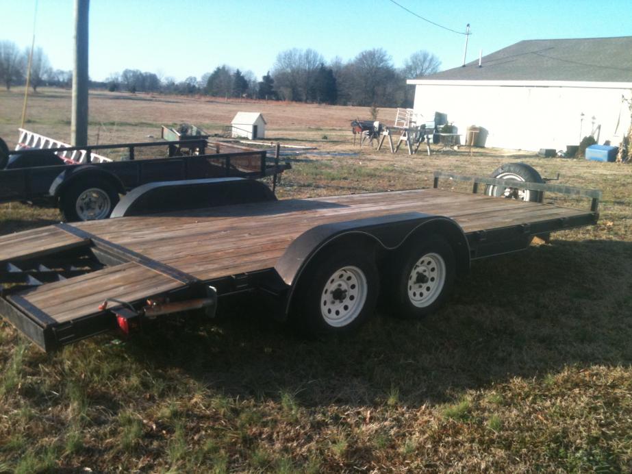

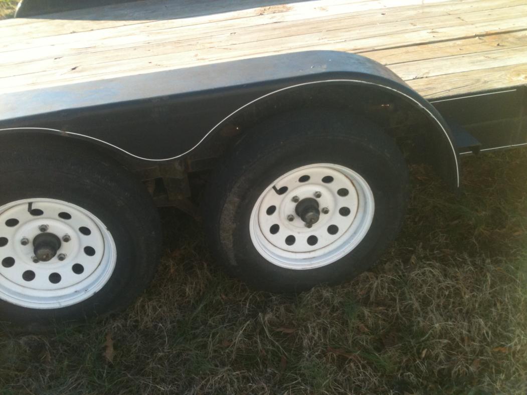

I have a 18' dovetail trailer with 2 3500# axles. The tires wore out very fast on it and does not handle well when loaded. The rims are only 5" wide and has st205 75 15 tires. I was thinking about getting some 6" wheels and going to a 225 8 ply. Would this help or do i need a trailer with 2 5000# axles?

I pull it with a 4x4 f150 and i have pulled with a f250 i think the rims are too narrow for tires i have loaded it diff ways and does not help

Can you post some picutres of your trailer and the wheels? You want the weight of you load over the trailer axels, to much weight on the ass end of the truck will wear the assend out and cause your springs to fail. 500lb tongue weight is all your allowd on most trailer hitches. Anything over 500lb trailer tongue weight and you run the risk of breaking your trailer hitch. Load the tractor forward and get the tractor tires over top of the trailer axels. Worst comes to worst you can invest in a weight distrubition hitch and get the trailer under control.

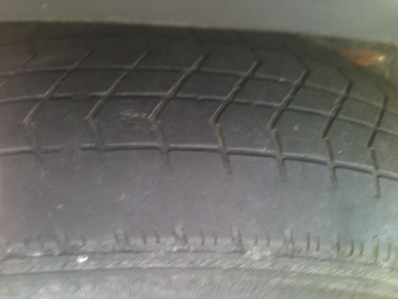

I may be wrong but those tires look like passenger car tires, you need to go to your local tire dealer and check on a set of 10 ply trailer tires. Belive me trailer tires will make a great deal of diffrence. I have a trailer very simalar to your in the pictures and it came with light truck tires ( junk ) I bought a set of 10 ply trailer tires pulls like a dream .

50psi sounds like alot of a trailer tire. Maybe your over inflating the tires and judging by the way they are wearing out unevenly Id say its too much air pressure. Check the side walls of the tires and see what the air pressure calls for. I think 35psi is all they need.

I agree that tires are a good place to start looking at. Also check your suspension, and the wheel bearings. Is everything tight? Have you had the bearings serviced? Are they torqued properly?
If you are loading the trailer properly, then it has to be either tires or suspension. I doubt that wind resistance would account for that much sway. Plenty of things are towed with a ton of wind resistance, and don't cause those conditions.
