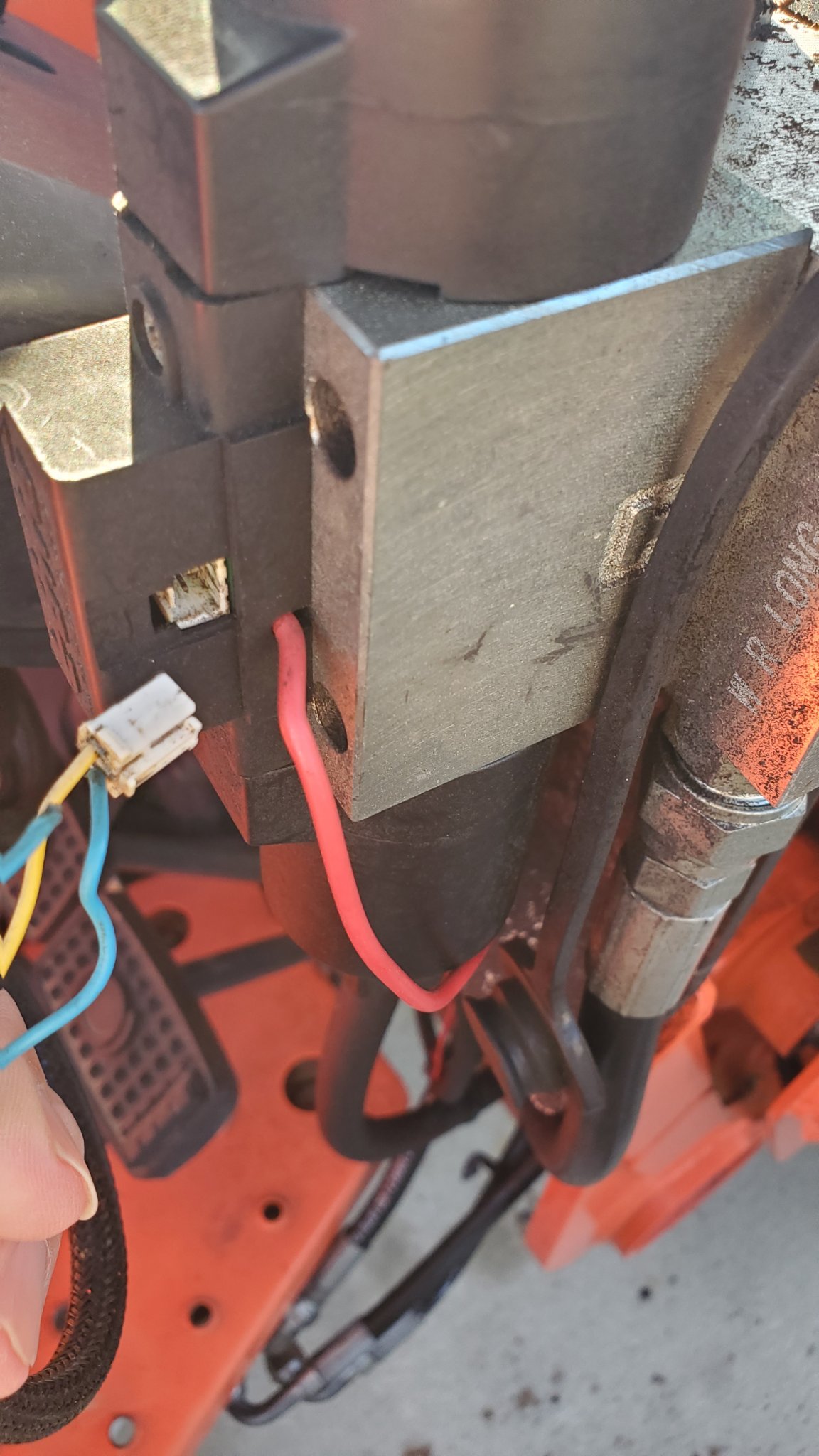

The wires for the valve broke at the plug where they plug into the module. Can the end of the plug that looks like a phone jack be replaced or do I need to buy the wire harness itself? Any assistance is appreciated.
Thanks,
Donnie

It looks like there is enough wire there to solder back together. Solder Seal connectors are an option if you don't have a soldering iron.

The tab in the connector can be removed, then solder the wire back onto it.
There's a section of the tab slightly bent to lock it into the housing. Gently press it down with dental pick or similar item,while gently pulling the tab out of the housing with needle nose pliers.
Yes it help to have 1 or 2 extra hands for this operation, or tape connector to 'something soild'.
Once tab is removed, uncrimp it, get rid of the wire, strip blue wire, recrimp,solder it. Now lightly bend the 'locking tab' up a bit, push tab back into connector, it'll 'lock'.
Thanks for the reply. The first wire of three broke even with the plug. I broke the second wire while seeing if I could take it apart. Too short to solder so plan B will be to try removing the insides and reconnecting them to the wires.
That sounds great! I need to figure out how to get the guts out of it without breaking something else! I'll try it tomorrow, weather permitting.
I called the dealer and learned the type of valve I have has been discontinued! If worse comes to worse, I may have to see about hardwiring it to sort of like the new ones are.

As a backup terminal release tool safety pins work great. Without a better picture I can not tell, but remember the terminal can go either in the front or the back of the connector plastic. Also you may need a new connector, if so try this site. https://connectorexperts.com/
Thank you for the reply. I'll try them tomorrow and hopefully they will have the part. I will add to the post when I find the solution!

If you have enough wire I'd try and re-crimp using a new connector. Solder connections in automotive/off road are a weak point prone to failure.

Problem solved. I found the system was made by rw long. I called the company and left a message. My call was returned and the gentleman provided a part number for the upgraded part that was hard wired and no phone jack looking plug to be pulled out by brush! The part number was VALCMWW and cost 80 bucks. I happened to be in the local JD store talking to old friends so I showed my friend Mike the part number. He walked into the parts room and returned with the part!
I should have it repaired by lunch!
Thank you to all that responded with solutions!
