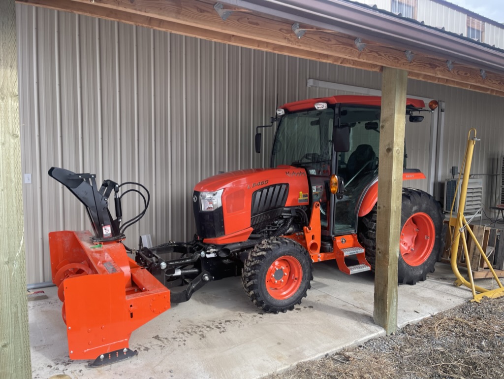

For some reason I think I need more power. I bought a L4060 in the spring and it does everything pretty good. The only time it was low on power was when I was deep tilling. I do have a 74 front mount snowblower for it, but I have never used it yet. I do have to blow some really deep snow at times.
A used L6060 will cost me approximately $12,000.00 more than my 4060 with the same hours. Plus there is the hassle of buying and selling. Prices are all over the place these days.
Is the extra HP really worth it?

It will be when you start blowing snow.

Do you know the maintenance of either machine? Options? DOes the L6060 have a mid-pto? Tires? Need more information then engine HP. I blow snow with a 63 inch front mount on a LX2610. I get more HP would be nice, but, I can go thru snow that is higher than the blower.

Mid PTO optional on L6060.
74" is not a small snow blower.

Currently have a cab or upgrading to a cab model? For $12k more it should have a cab
