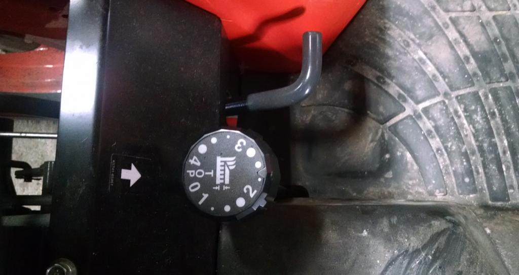

And the dial has the "lock" position to hold deck up and allow use of the 3 point hitch.
