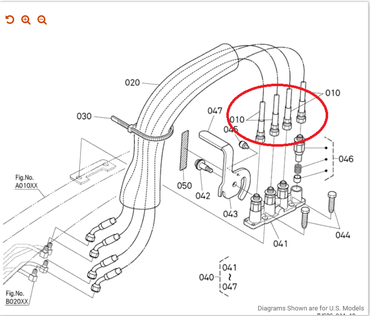

Let me start with an apology - I have been thinking in terms of the oil flow on the larger machines and the BX23 does it differently. On the BX23 the pump is in the rear and power beyond flow goes to backhoe first, through backhoe valve to loader valve, out the loader valve power beyond port and back to tank via the 3pt valve. So the backhoe valve and connections can be eliminated as a source of the problem.
The 4 way quick coupler on the loader hoses also complicates the testing. Let me start there. Here is a picture with the 4 way block with the cylinder hose connections circled. I don't know which hose is which so you need to follow the hoses/pipes to determine which hose goes to the rod end of the lift cylinders. That is the one we are going to disconnect (unscrew) from the 4 way coupler. Do that with the loader firmly on the ground and put the end of that hose in a bucket. Now start the tractor and try to raise the loader.
DO NOT MOVE THE JOYSTICK TO THE LOWER POSITION WITH THAT HOSE DISCONNECTED
RECONNECT THE HOSE IMMEDIATELY AFTER THE TEST AND BEFORE TRYING TO LOWER THE LOADER
ATTEMPTING TO LOWER THE LOADER WITH THAT HOSE DISCONNECTED MAY MAKE A BIG OILY MESS
If the loader does not raise with that hose disconnected oil is not getting to the base end of the lift cylinder - e.g. the base end coupler is not properly connected.
If the loader does raise with the hose disconnected we know oil is getting to the base end and there is a blockage somewhere downstream of the open end of the hose. Could be the quick coupler for the rod end hose or something in the power beyond circuit.
Run that test and we will decide where to go next depending on what it tells us.
