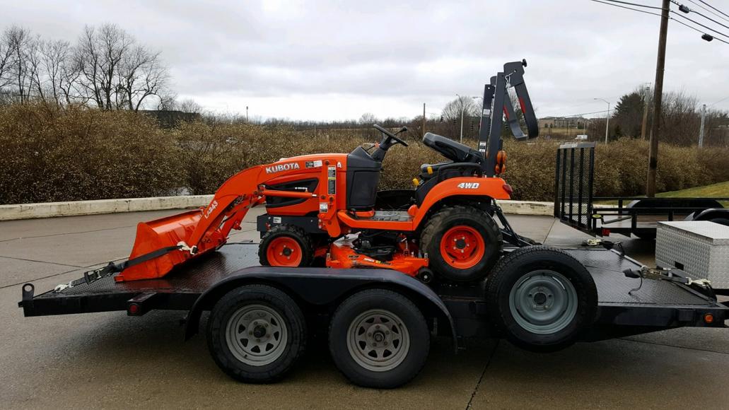

It's a 2014 BX2370 bought off the used lot of a John Deere dealer in Kentucky. Since it's seems to be an expectation that you post pictures, I've attached a pic of mine sitting on the trailer on the way home...in the rain.
