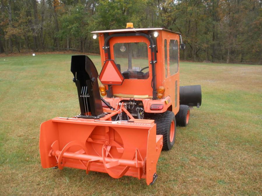

I have the Kubota 54" (who knows who made it) on my 2360. Just have to adjust you speed of the tractor to depth an how heavy the snow is. I think with your unit adjusting to the snow you'll have no problem. Have fun with it.
