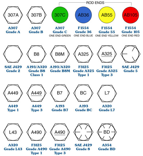

Go to any hardware store to buy these by the dozen for what you would pay for 1 at the dealer. A grade 2 bolt has no marks on the head. Refer to the included chart.

That's just a off the shelf normal 1" long course thread 5/16" grade 2 bolt with a nylock nut.
Like O7wingnut said, go to a local hardware store and buy them by the handful.
They will just be a non labeled silver bolt.
