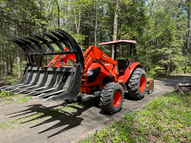

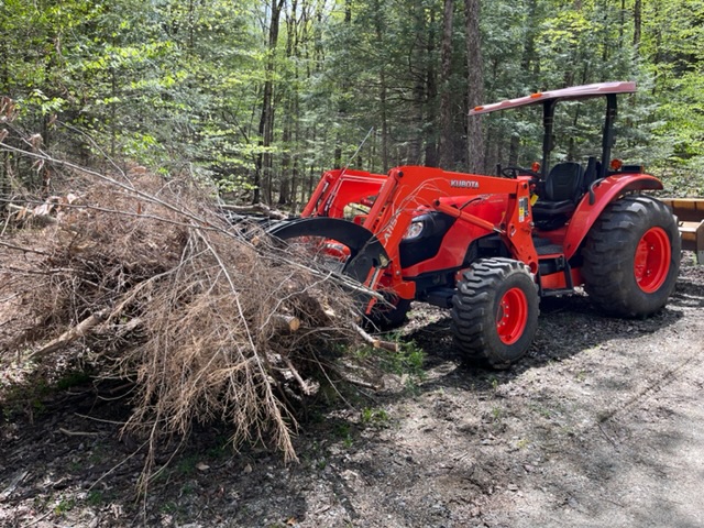

Made good progress on the grapple and box blade.
I ended up going with the 74" grapple from Wildkat (aka Mid State Attachments) http://www.msattachments.com/-2-extreme-root-rake.html
They had good reviews online and the piece seems pretty rugged. I gave it a good workout this weekend and am pleased so far.
For the box blade, I found a used Gannon (Woods) 76" unit with a hydraulic ripper assembly. There was an earlier suggestion to get a top and tilt set up for this, which I'm working on now. I've got a three-valve set up on my machine, so I just need to get the correct cylinders for the top and side links.
