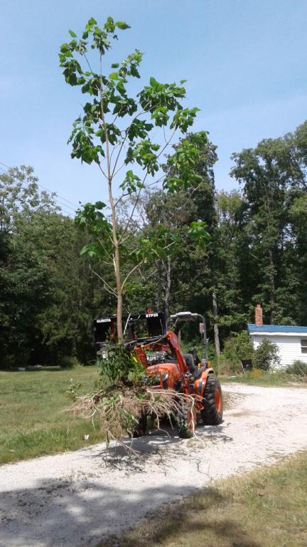

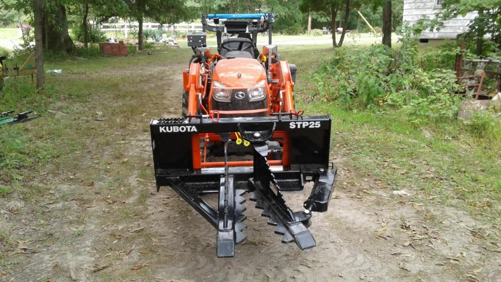

26hp tractor, loader pulls small stuff, clamp onto medium stuff and drive forward. Rock tractor back a forth while lifting with loader for larger trees. I max out around 5" diameter with my setup. If you have 50+hp look into the Intimidator brand of tree puller.

I have done the off the tractor, hook up, on the tractor method to remove bush creeping into our pastures...
If I needed to do more area and more often, my thought is I would mount a grabber like shown in post #6 to the 3 point to pull bush.
Then use my pallet forks with homemade brush teeth to move it..
My 5 cents of opinion..
