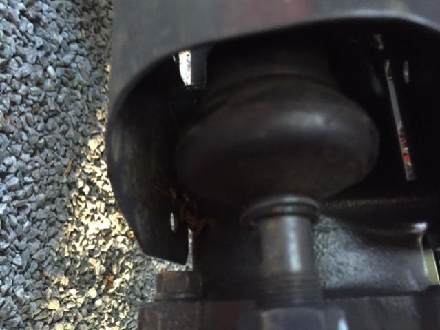

Hey guys. I'm honestly not sure why Kubota didn't extend the boot shields on the L series tractors another 2 inches to protect these boots from being torn, but I have torn my left side boot on the tie rod end. I was hoping those guys that have replaced this boot could offer some advice or tips on this job. I'm sure as easy as this one tore from bush hogging a field, I will become very proficient at this repair. Again, not sure why Kubota didn't extend those shields just another 2 inches. Crazy.
I have attached some pictures so you will see the exact boot I tore. If anyone know's the exact part number for this boot as well, that would be great. Any advice changing this out is appreciated.

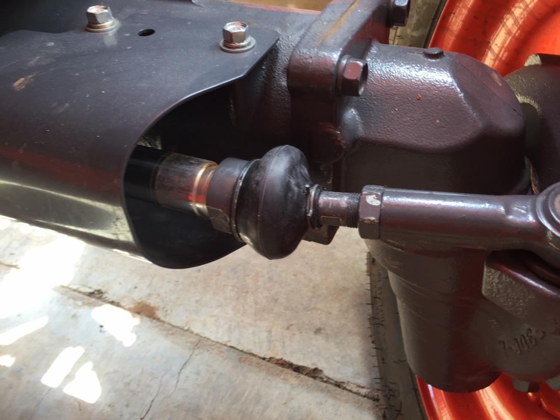

I don't know the part number but is fairly easy to replace. Turn the wheel so the boot is extended out from cover. You will have to drive the tapered end from the wheel spindle and then remove the tie rod end. The boot can then be replaced.

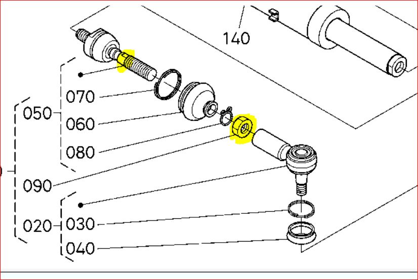

It's a little simpler than jzeurcher says, his instructions would be to change the seal on the tie rod end. ;)
P/N 32580-44780 $5.97

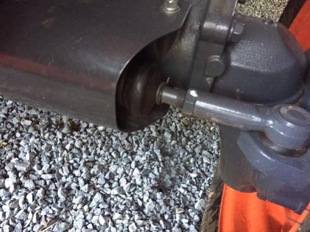

And to answer the question why the shield does not go farther out, it will hit the rod or ends if it's farther out, and if the shield hits the ram rood it is quite spendy to fix!
Slide the 2 spring clips off either end of the boot, slide the boot down the tie rod end to expose the lock nut and end of ram joint.
lossen the nut (#90) then thread it back till it bumps the tie rod end (#20), (this give you the mark for the threaded rod so you know how deep to go back in), unthread it replace boot, reassemble. ;)

Awesome diagram. Thanks a ton. My local dealer has 4 boots in stock. I may go ahead and buy all 4 since I'm sure I will be tearing more in the future.

What is the part number for 060 in that diagram? The part number you posted is for the 020 swivel taper joint, 020 in diagram. Thanks, I'm having trouble finding it.

Above diagram and part numbers are under steering - G18002 STEERING CYLINDER
