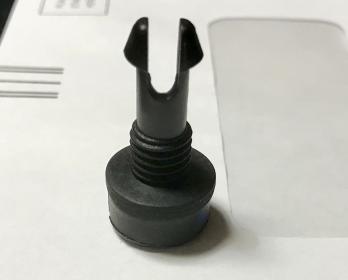

Here is what I know from the drain plug on my L3560: Kubota tech was out to pick up my B tractor, and I was planning to change the antifreeze on the L myself before fall. He said "you'll have trouble with that drain, let me get it started for you, but plan on replacing it." He used the biggest Phillips head I had, and got it loose, it is indeed threaded. The slots on the head of the plug are kind of stripped but useable for the time being. I ordered a new one ready to put in, part no. Tc422-16070 in case they are the same. Looking at the new one, the shaft is threaded for the first 1/2 inch, then it splits in two like a clothes peg, and the ends bulge out. The shaft is hollow except at the head.
I'll try to get a picture, but the ends would prevent removing the whole thing unless you can get something on them to pinch the plastic together. Maybe it is designed so it will drain but not come all the way out?
So before trying to remove yours I would recommend picking up a new one to have on hand just in case...I think it was just a couple bucks.

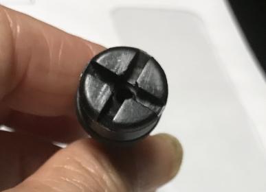

H He said "you'll have trouble with that drain, let me get it started for you, but plan on replacing it." He used the biggest Phillips head I had, and got it loose, it is indeed threaded. The slots on the head of the plug are kind of stripped but useable for the time being.
Check the new one, it's probably A JIS head (similar to a pozidriv) not a phillips head, so using the wrong tool stuffs it. (Very common!)
Absolutely correct! It's a #3 JIS

I used a large, stubby handled flat head screwdriver. Its plastic and threaded.

The plugs in the l3560 and the B2650 seem to be identical. There is a rubber washer at the base.
I can't tell from the pictures... are those threads pitched like a screw or are they stacked? What I mean is - does the plug thread on by twisting or do those threads act more like a seal?
The threads are a pitched spiral, so intended to be twisted to remove.
