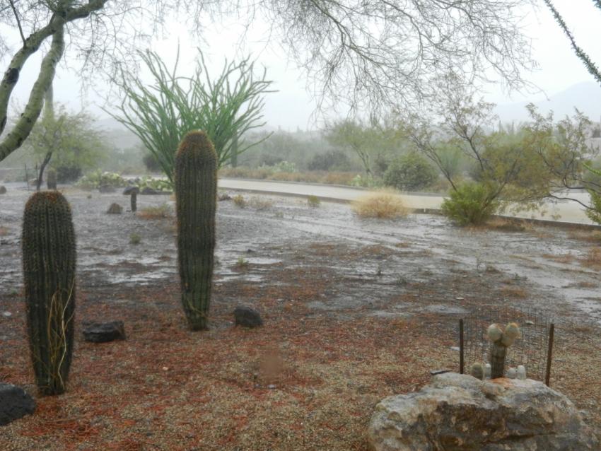

Water runoff in the desert is really tough because what the Northeast or Northwest gets in rain in a day, we can get in an hour. These were from 2016 and the damage was considerable.
Here is water sheeting off my old front yard..
Once it overflowed, it cut across the driveway, transporting a couple three of tons of granite with it. Every time we got a heavy rain, it would trash the driveway.
I put in two retention basins and a third overflow basin. We got two inches of rain in an hour last month and I had zero damage from the areas I repaired. What a nice difference, all thanks to my orange machine.

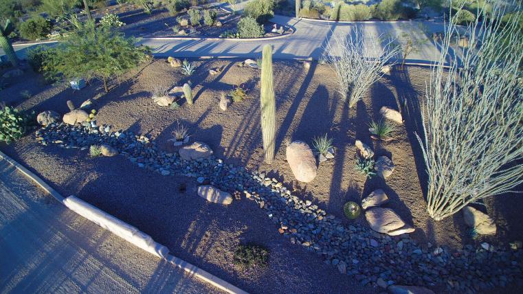

Thanks. Those pics were pre "water project." Here's a couple completed pics I shot from my "big ladder." :)
Here is a shot of how weedie it was when we bought the place. This is right about where I put the rip-rap river bed.
When we bought this place, my wife and I pulled all the weeds in the front yard and back yard by hand -before closing. There were four "brand new" galvanized garbage cans on the driveway that were full of garbage. They had been there so long the bottoms of the cans had completely rusted out (almost two years).
