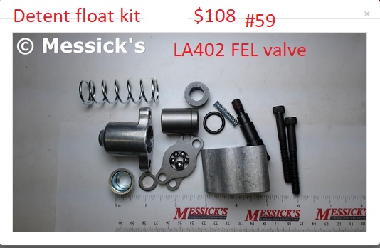

I believe your tractor could come with a loader LA402 and that is the same valve you have for your blade.
There are 5 variations of FEL valves for an LA402 from what I see on Messicks.
The first 3, B00101, 00102, & B00103 do not show a detent in their parts list.
The next two starting with B00501 have a float detent kit.
From the Husco info, perhaps Messicks can at least tell you which of the 5 valves you have and if it is one of the first 3 then no you do not have a float detent.

While I am now thinking you may not have float, one thing to note is that the end caps of the spool can be subject to moisture and corrosion problems that render a float function on them inoperable, if they do have the capability.
Point being is there is the (unlikely?) possibility it has float, but needs a rebuild.

Both valves have the same end caps and are the same length. In looking around it looks like the valves that have the float function are longer than standard.
