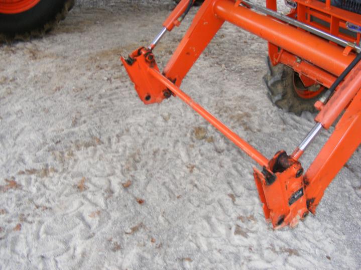

I;m sure you already know what a skid steer type looks like. I'll attach a pick of my Kubota style QA. After using both kinds I prefer the Kubota type over the ST kind. The Kubota QA has no moving parts to wear out. I love it. Just pick up the bucket or forks and lift it up then put in the bottom pins. Not that the ST type is hard to use but they are no where near this simple.
