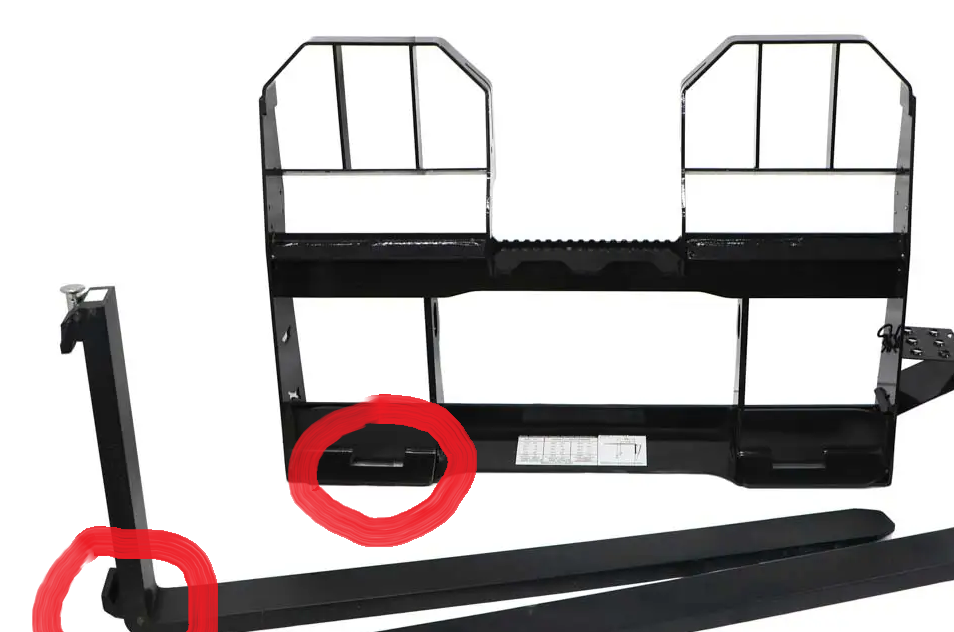

if you are going to pull with your tines (versus lifting) this "tab" that holds bottom of fork to cage is a weak spot. First hand experience says not a good idea. Also if you have QA style mount stress to bottom pins needs consideration.
So you mention you want to yank something big so depending how big/heavy needs consideration also. tines designed to lift of course not pull. Using both tines to pull at the same time would require both tines close togther otherwise you going to introduce another force of pulling tine tips together in a twisting motion which is probably a very bad idea on anything of weight. Consider hooking direct to cage to yank that big thing you speak of.
