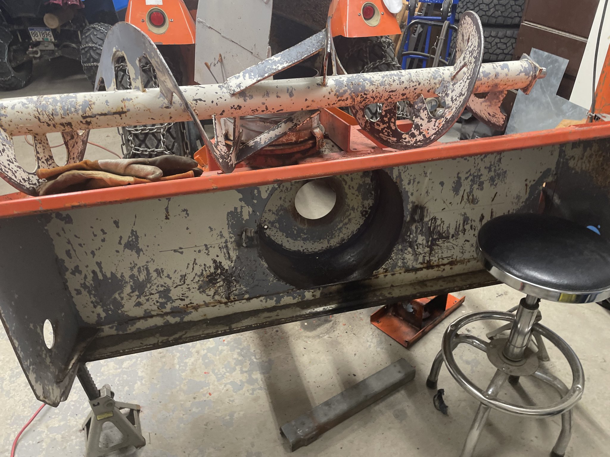

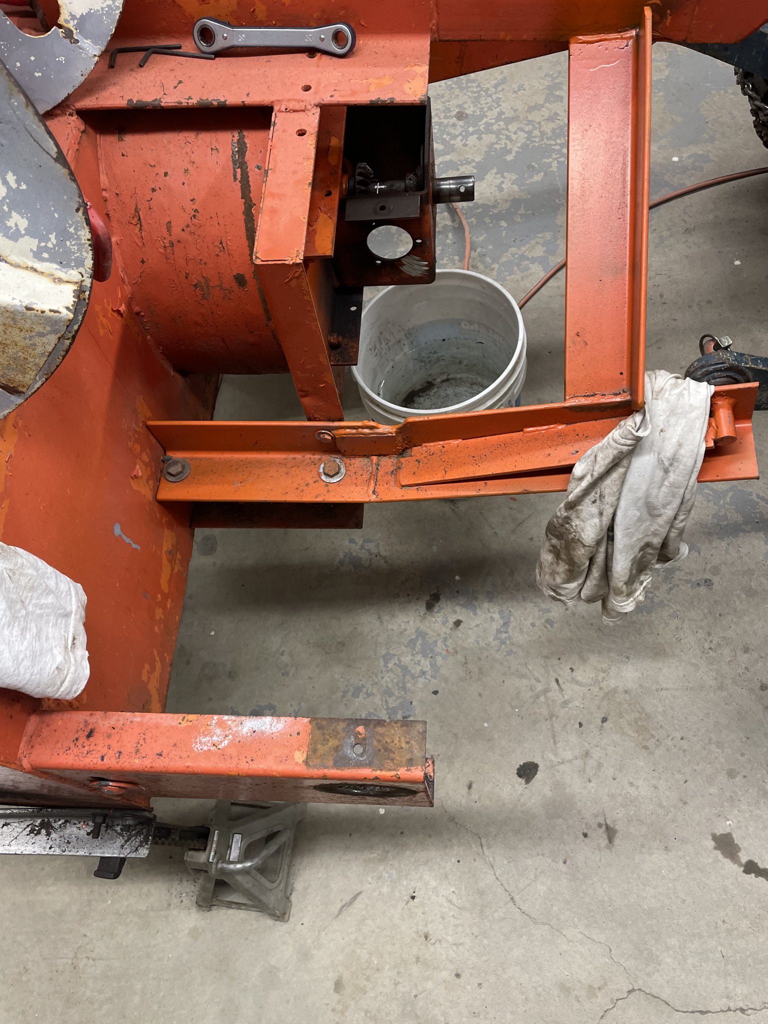

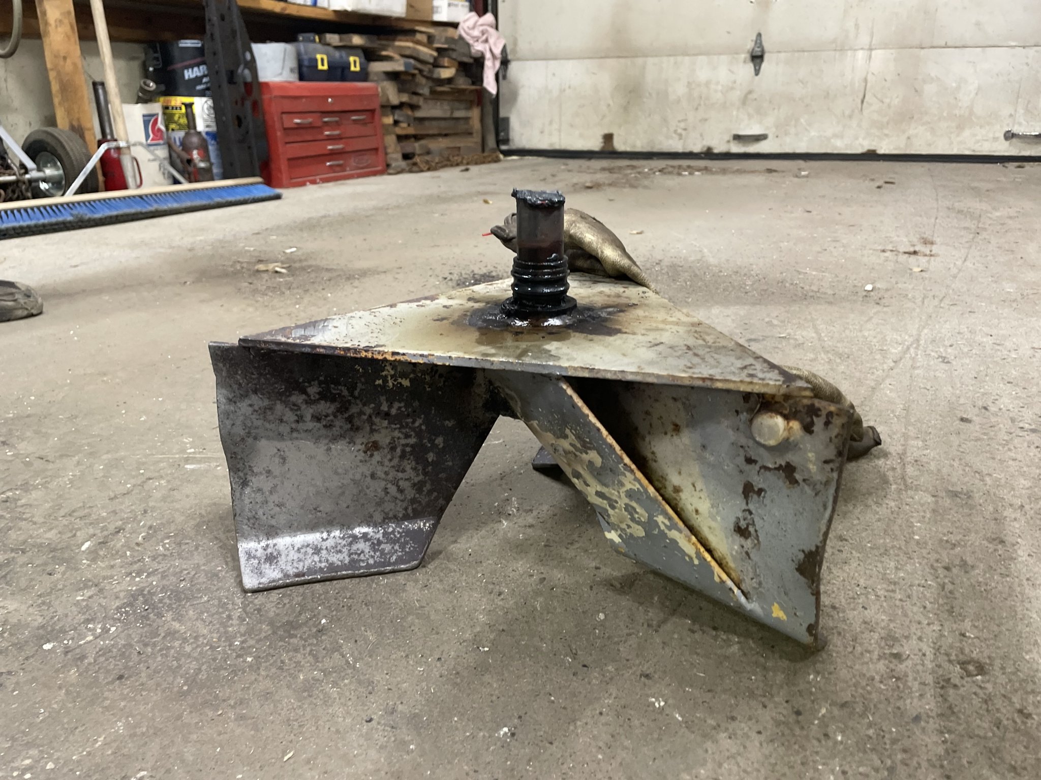

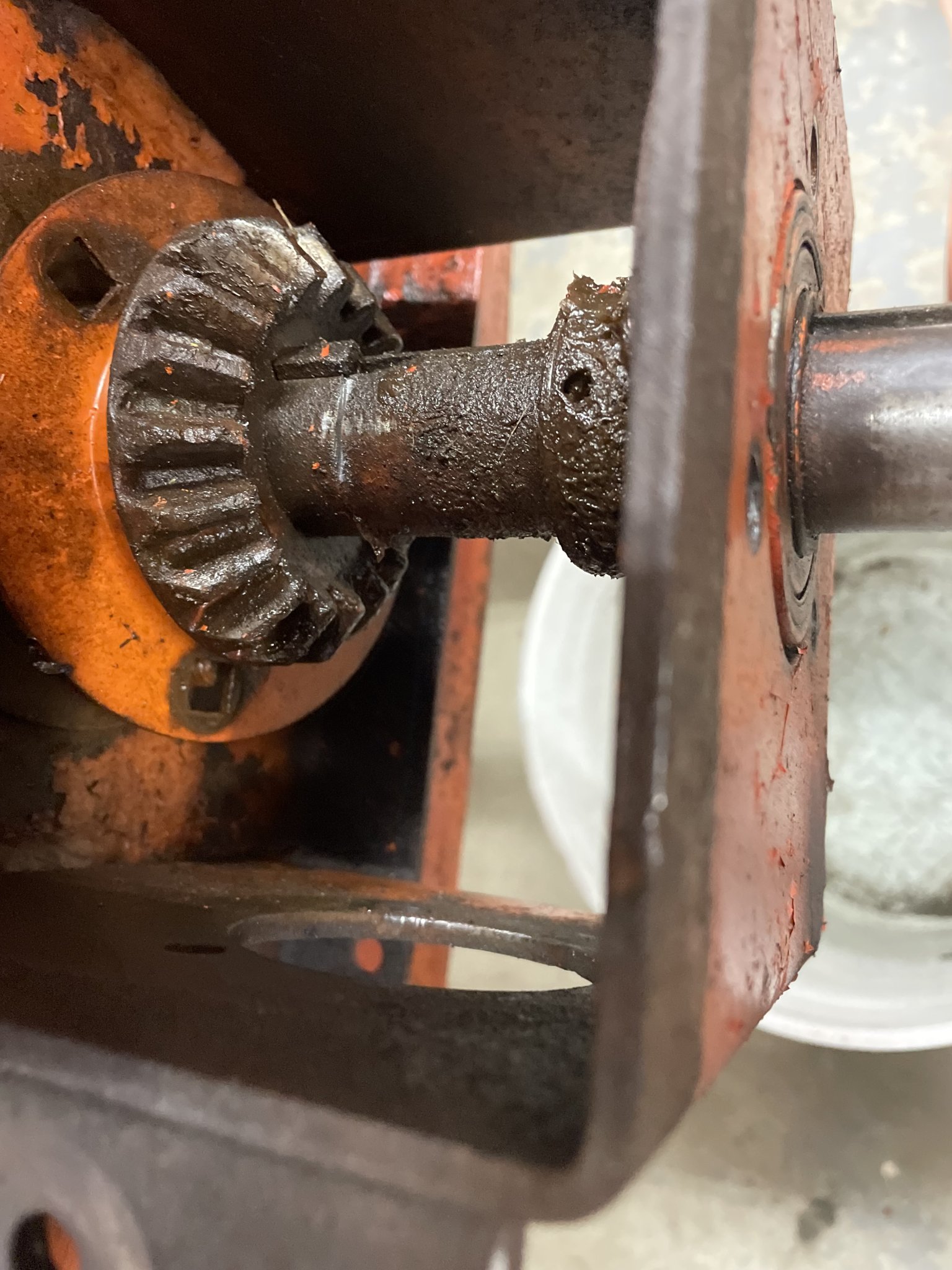

So after some zip discing and cutting torch love,I got it apart,soaking all the parts with penetrating oil all summer did not help,as I cut stuff open you could see were the fluid had gotten under every thing,it was just to far gone,it took 18 tons just to press out the main shaft from the blower,
Assembly starts later this week.

Guessing you got the implement for a song.
Sounds like it was a chore, but that piece looks to be quality enough for the attempt, with the tools to do so.
I think your efforts are going to be in your favor when finished. That's a BEEFY unit.
When I'm done parts included about $1600 CDN/$1170 US

Yup,thanks,it is a rear mount,Buddy picked one up a used one for his BX23S for $2200 CDN,have yet to see it.
Being a rear-mount is ass backwards (no pun intended) in design, but given the times and use....it is what it was.
Tractors these days (along with useability) open up application and use. Given that, have you considered making it a front mount, or is that more of a feat than envisioned?
Disregard my last, I just noticed you have one of the Vintage tractors. You're doing an excellent restoration for your era of machine. 👍

"soaking all the parts with penetrating oil all summer did not help"
Another time, maybe buy a gallon of "Kroil" ( Expensive! )
Those here who have used it will agree,......It is magical stuff!
Some say, that you can make a cost effective Kroil equivalent, with equal parts of transmission fluid, and Acetone.
I did use the trans/acetone solution and followed up with some Seafoam penetrating fluid for around 6 months almost weekly,as I said every thing was wet on the shafts,it took 18 tons on a press to push the shaft off of the blower and both sides were moist from oil's also,I guess 43 years of unknown history ??
