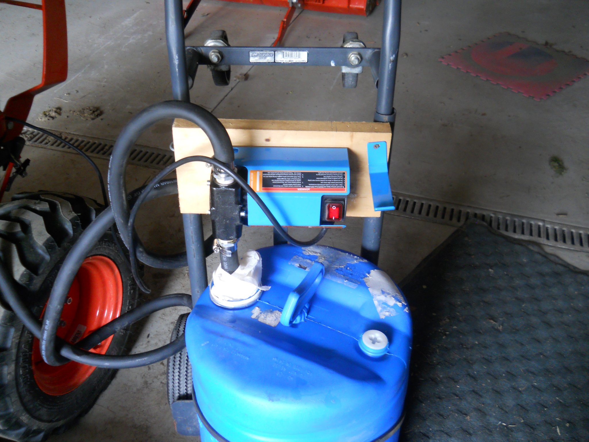

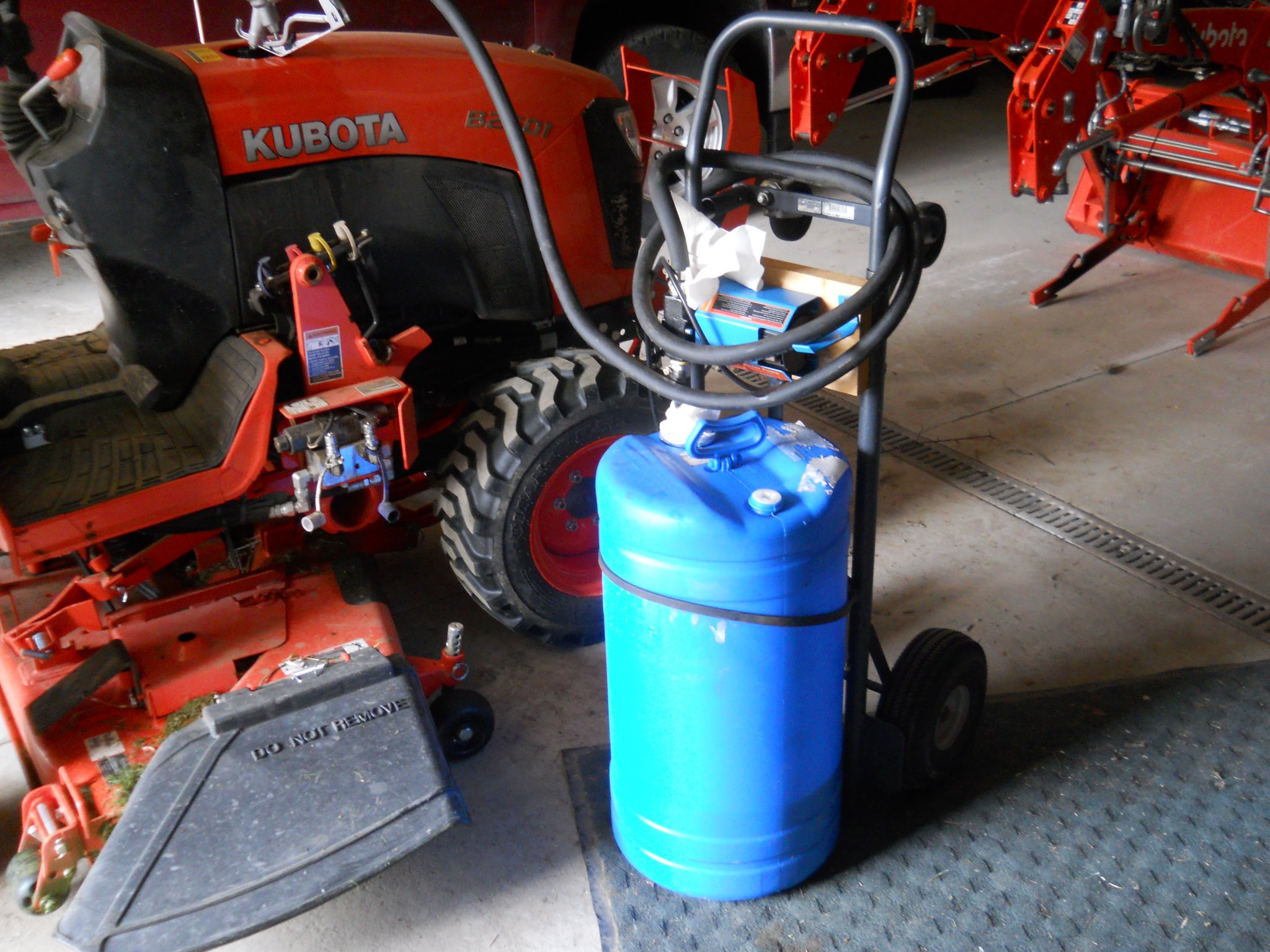

OK I put together
14,163
2,826
a fuel tank and pump HF had the pump with all the stuff and I had some coupons sooo I got it the hard part was finding a 15 gal drum. So to day I tried it out, this pump is suppose to pump 10 gal a min. All I know is it took a lot longer to fill the drum and it did to pump it out. Not my video but this is what I did might help somebody else

How are you transporting the 15 gal of fuel from station to home and to where you are storing it? Is the barrel attached to the dolly permanently?

D2 the transport will still be in 5 gallon cans and dumping fuel at waist level isnt to bad, right now it has a bungie strap till I get the bugs worked out, But I will come up with something a bit more substantial , I will TRY to get a picture tomorrow and re figure out how to get it on here,, puter geek I aint! The other thing that did cross my mind was I have another 15 gallon barrel soooo maybe a rack in the bed of the truck and a syphon feed into the other one.. I ll figure out something

I need to mod the bung some how to keep the nasties out

Skeets - that looks like a nice tank/pump setup!
What was there before you removed it? I would think that you may be able to get something that screws on the bung that is flat. Then a hole in that with a grommet that fits the hole? You might even be able to just rotate the barrel and use one of the flats on the barrel and a grommet or bulkhead fitting?
That bung looks like the same size as the larger one on 55 gallon drums. If so, I'm pretty sure there's a telescoping pickup that will thread right in. Probably available from HF as well, but if not, check Grainger (even though they're pricey). Even if it's rigid, you can cut it to length, and use the little bung for filling it back up. You might want to put a little more vent on it if you do to keep any splash from spraying out around the fill nozzle. I worked with an uncle that was a logger when I was a kid, and my job was to refuel his machines at the end of each day, then take the drums for refill the next morning on my way to the site. The drums all had pickup tubes in them, and I always filled them through the smaller bung. The small bung, IIRC, is 1" NPT so a valve can be screwed into it with readily available pipe fittings. I'm thinking the larger bung is 2" or 2-1/2" NPT. I didn't have enough experience to run the big offroad machines, and he wouldn't let me near a chain saw. I think he'd heard about me wrecking a wheelbarrow at school, so figured me and large equipment in rough terrain were not the optimal mix.

The old 2 wheel hand cart I had laying around and Lord only knows what the drum had in it (5 bucks). Turns out the small ones are harder to find than the big ones.
The BX is no problem but the "B" is in a rather difficult place in the hood for a crippled up old guy to fill,, you know the old saying,, It aint the age its the mileage ;)
