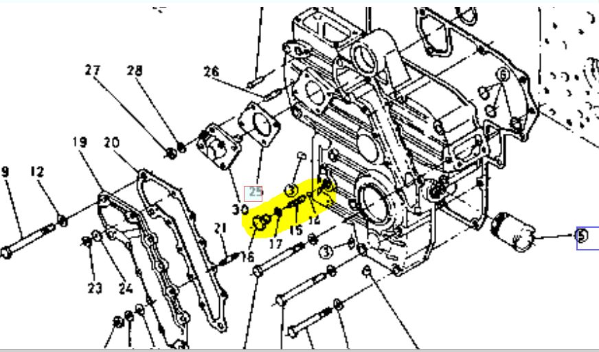

Is that check ball system something that can be repaired? What would Kubota call it in the illustrated parts list?

Sadly probably not without extensive work, the seat is aluminum and prone to wear after a long time.
It's really not necessary to worry about, because the oil system moves oil to all points that could be harmed extremely fast, hence why you don't have a bearing issue. ;)

Wolf, … what label does that illustration give to identity that part you highlighted? (Are you certain that's an anti-drain-back? … or is that a pressure-relief instead?)
