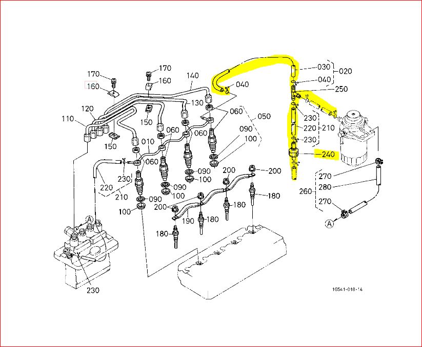

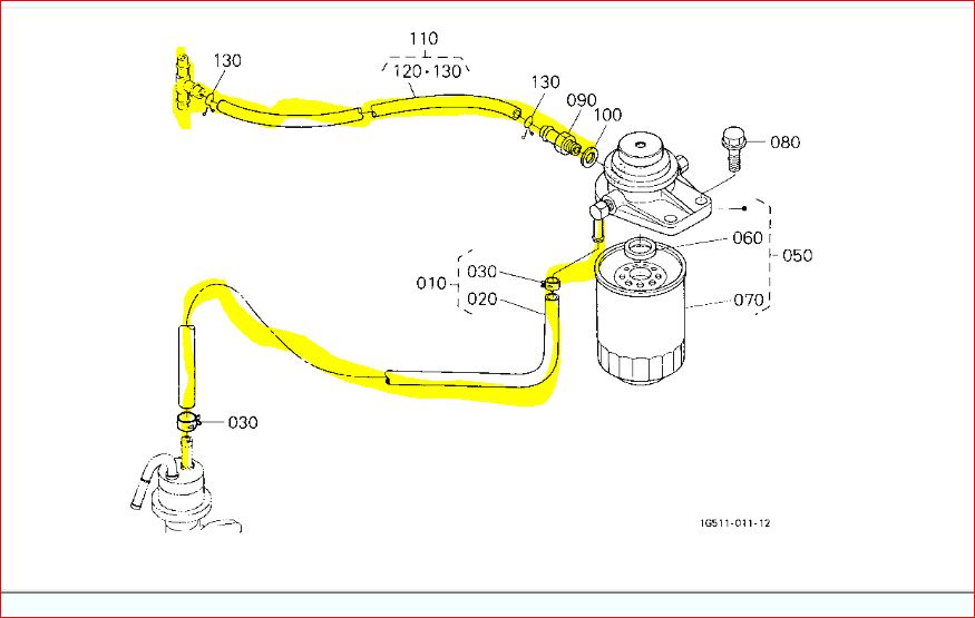

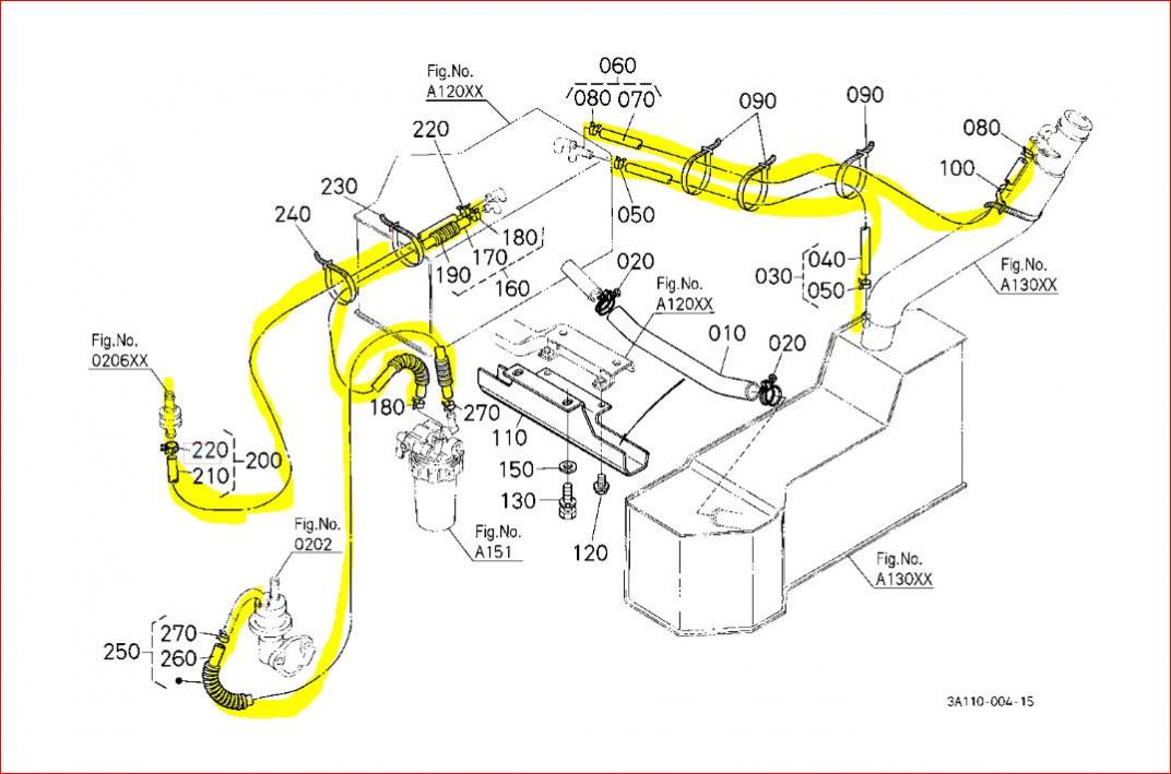

I'm having a problem with the fuel system on my M6800. It has about 1,100 hours. Air keeps getting into the system. This seems to be the by-product of it sucking fuel as indicated by the pump above the fuel filter sucking down tight. Air comes in and out of the settling bulb filter. When I replaced the filter I noticed that it was but half full of fuel. The new filter was filled prior to being installed.
After talking to my dealer, I've flushed the tanks and all lines. I replaced a small line, apx 1/8, which comes out of the pump mechanism and goes to a T located behind the filter. It was crimped.
I've loosened the injector couplings to allow air to escape, all per the video instructions of orange tractor talks.
The service manual has been no help.
I've ordered a new fuel pump, the low volume one located the on the side of the engine.
I'm truly at my wits end! Dealer or qualified mechanics can't get to it for week to two weeks. We use it to bale hay and our alfalfa is staring to bloom! Help!

Have you checked the vent lines?
It should have one on either side of the tractor. My 9000 has them hooked to the frame work that supports the rear of the hood. Dirt dobbers are bad to plug them up.
Is your fuel gauge working properly?
On mine that is the first sign that the vent lines are plugged. It all but stops the fuel transfer between tanks.
If the vent lines are clean I would check the fuel line that comes from the tank to the primary filter. It could be plugged or even coming apart on the inside.
I would look at all the simple stuff before starting to spend money on it.

for a few bucks you can replace the rubber lines, fuel lines will collapse internally and have no signs of a problem on the outside. the will also flow fine with no suction, the suction is what collapses them.

I would check and make sure you get flow from the feed of the tanks, as a plugged vent will not normally cause a no start condition. ;)
And make double sure on the filter and water separator seals as a leak on one of those will also cause it to suck air.
