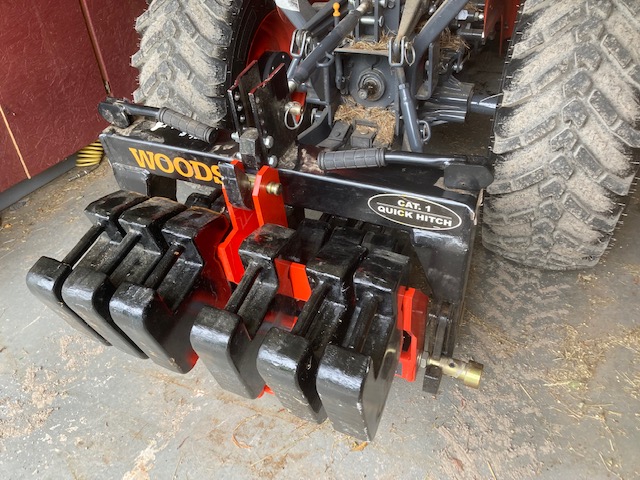

I have a Woods quick hitch. It is probably made by Worksaver, near as I can tell, an educated guess. It was a bit cheaper than Kubota's, was available, and turned out to work with ALL my implements. Here is mine with my Heavy Hitch weight rack attached. I also put on a wheel spinner and a step, which is for the LX2610, I think, but fits nicely.
Goodworks Tractors is working on a heavy hitch that attaches to the sides of the QH so you can still hook up an implement.
About the 10 min mark in this video...not sure if it will end up being useful or not.
