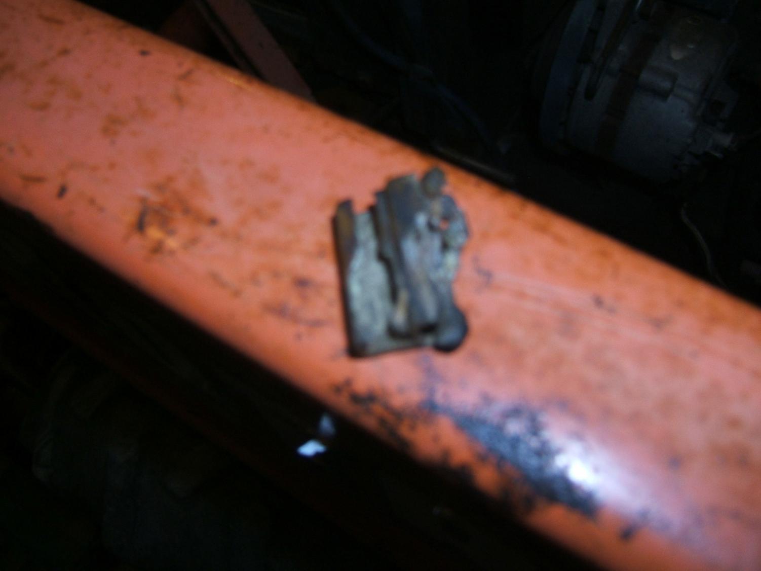

Never thought I would be asking for help with an electrical problem because I am “usually” pretty good at chasing them down. Just to keep it interesting, it is an intermittent problem. Sometimes when I use the glow plugs the connection where the fusible link is connected to gets hot enough to smoke and start to melt the connection. The wire does not get hot and the link does not burn.

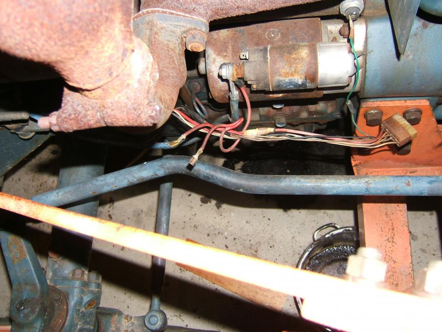

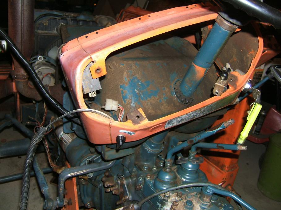

I have torn the dash complete apart and used a VO meter and visual inspection both with the ignition on and off. I can not find any shorts, melted or bare wires or lack of continuity where there should be or continuity where there should not be. I have also used an IR gun to look for hot spots, you guessed it, I found none. IR gun shows glow plugs and indicator heating up, (sometimes with smoke from the connection other times none). Continuity on all three plugs check positive. I have not pulled the glow plugs out yet. To do that I have to remove the fuel lines to the injectors and remove the intake manifold to take them out. I replaced the glow plugs about two year’s age.
