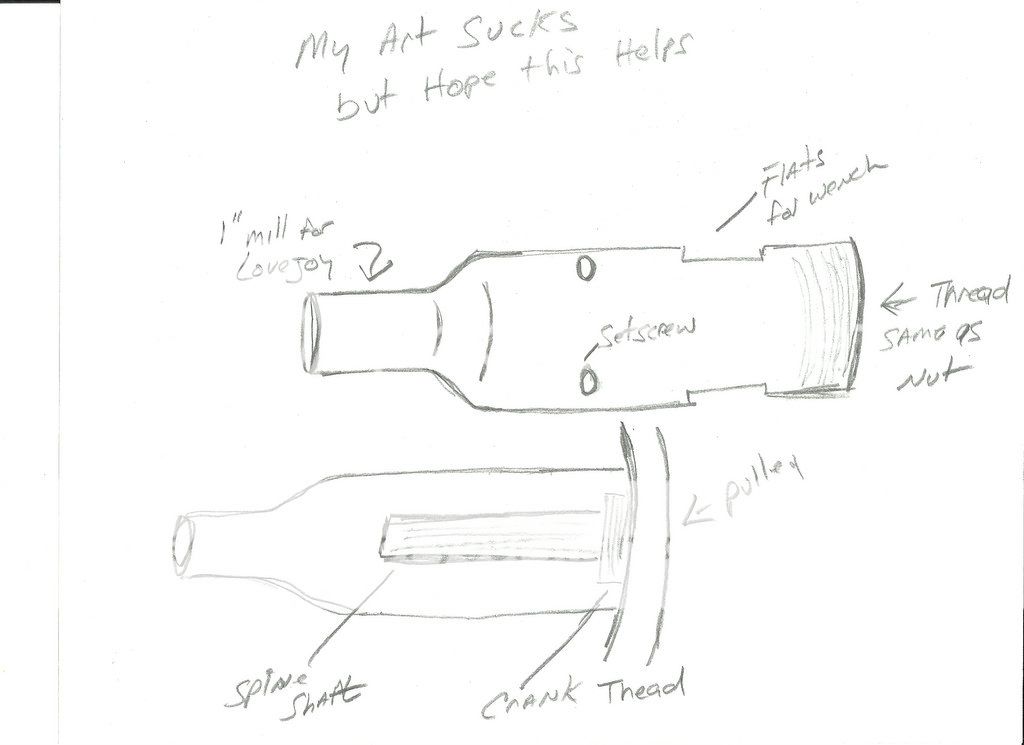

Another way to do it, probably my approach for simplicity sake-
Take off the pulley nut.
Measure the splined stub on the crank shaft.
Have machinist use round stock, 1.5" or 2", whatever it is, have him drill out the center for near press fit over the splined stub and extend out about 1.5" from it. Have him thread the inside at the pulley end the same as the threaded nut. At the pump end, have him turn it down to 1" for the Lovejoy. At the splined section of the adapter, have him drill and tap for 2 or 3 set screws, the set screws will be tightened against the splined shaft. Have him mill two flat spots on the adapter near the pulley so you can get a wrench on the adapter.
The new adapter becomes your new pulley nut and new stub shaft.

The idea here is........
For someone to create an adapter that will be as true to the crank as possible. Vibration will be your killer in the long term.
Also...see if your machinist can send it off to heat treat, may cost you about $50 but once threated it will outlast your tractor.
Yeah, you may come up with a rigged something or other that will get you by for a while, but what about 3 years from now?

LSMurphy could you please draw me up a quick diagram like Wolfman did so I can understand what you are suggesting? I think I understand most of it, but not all.

I piece milled adapter.
The set screws will take the pressure off the crank threads, and if the machinist drills out the center for a slip/near press fit.....there should be little pressure in the threads anyway. The set screws will also ensure that the adapter does not back thread and come lose.

BTW.........I say 1" lovejoy........could go 3/4 or 5/8 even....whatever works best and cost less.
You are only turning a pump........5/8 shaft will be plenty.
